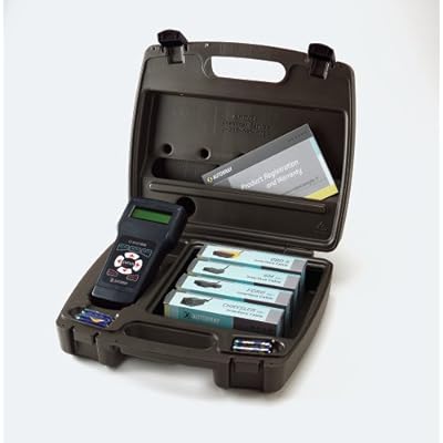

If you do any of your own wrenching, you really should have a code reader/scanner.
The Auto X-Ray EZ 2000 is what I have. I paid $199.00 for mine last year and it has paid for itself in reading codes. This reader is OBD I & II compliant so you can use it on any other car that uses OBD codes (all cars from 1996 forward are OBD II compliant).
You can now get a new one for $79.00. I wish I had this sweet deal last year.
http://tinyurl.com/6hcwhp
