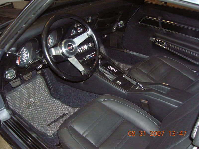

Here are a few pictures. Owner just had a GM crate motor installed. I'm doing the interior and weatherstripping (should have taken a couple before pictures). Just waiting on a few parts to wrap it up. I found the seats on ebay for $260.00.
Here is a C3 that I did:
