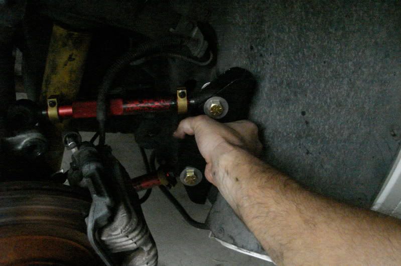

About 5 years ago I did the full energy suspension polybushing kit on my (then low mileage 95) A few months back I replaced the stock dogbones that had ES polys with these....
and the car actually rides better while maintaining its one rails handling abilities...
Mike
I may get the urge to install my delrin pintop shock mounts soon.........
However, my coilovers will probably remain on the shelf...
In summary if I had to do it over again I would not install polybushings on the rear of my car....suspension was STIFF.....with the rod end rear handling remained at least as good as with polys but car rides much nicer especially on Lousiana concrete roads...
Mike
