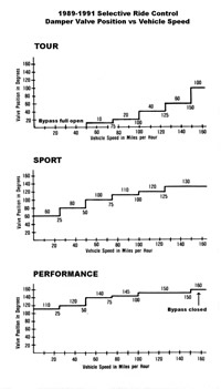

The reason you guys dont feel a difference is because the system is speed dependent like C4cruiser said. The shocks never reach full stiff until 150 MPH. Any of the speeds you see on the street wont have much of a difference between the settings.

Here is a chart showing the speed differences and stiffness.
