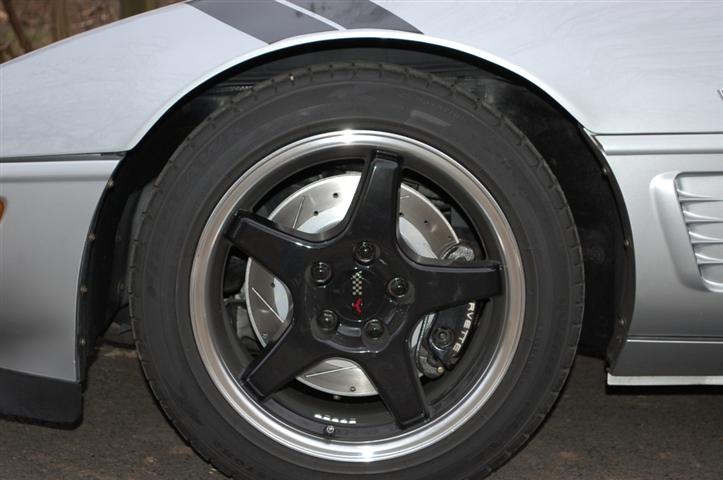

I just bought these yesterday for my 88 vert. $180 for rotors and pads all 4 wheels from Adam at BrakeMotive, a vendor advertizing on here. Link below to his ad. He also carries the 13" J55 option if you have the big brakes up front.
Based on my research and other's reviews, these are a nice performance option (ceramic pads and cooler, zinc coated rotors) and look really nice too. If you have a more open rim, they really are nice to show off.
http://forums.corvetteforum.com/c4-p...ices-ever.html

Originally Posted by Tony A.
I just bought these yesterday for my 88 vert. $180 for rotors and pads all 4 wheels.

They look like nice rotors, but personally I never use drilled rotors. Only rotors with the holes cast in (Brembos only AFAIK).
I have had issues with cracks on drilled rotors when doing track days. This is on my previous 911. It had 12" rotors on a car that weighs in at 2400 lbs or so.
I would guess that with a 13" rotor and the heavier C4, they might be more prone to cracking even on the street.
JMHO.
