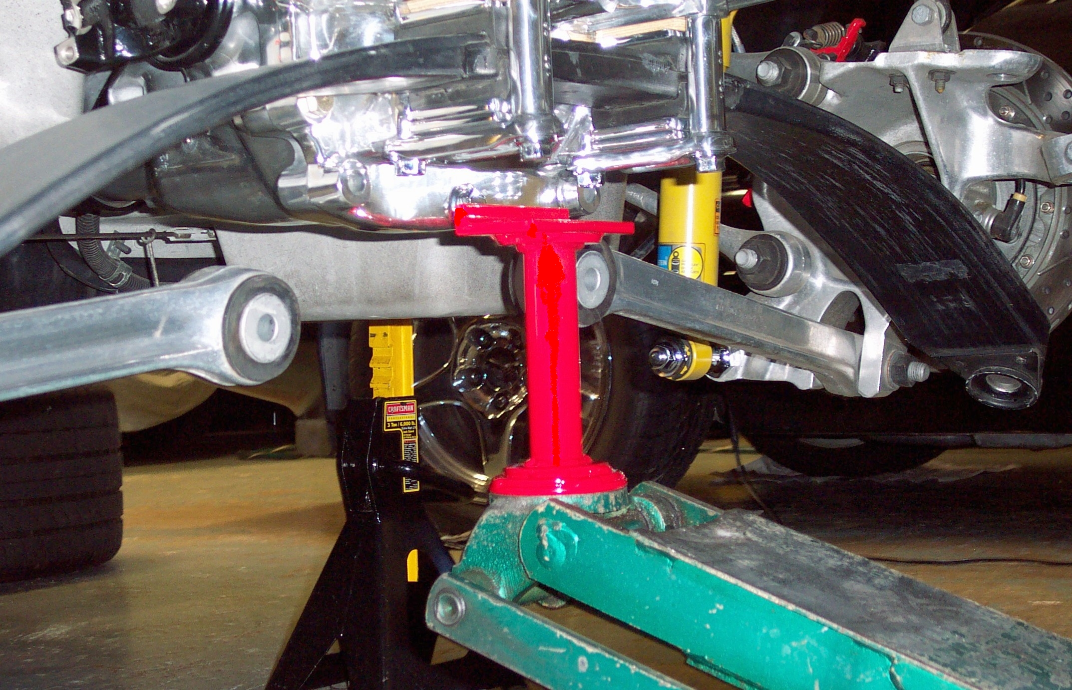

I just ran a search for a floor-jack adaptor for my '89 C4. The Gadgetman came-up as a source, but the website is apparently down.
Any other options for a floor jack adaptor for the rear-end? Just purchased a low-profile jack from HF, but need some way to get the entire rear of the car raised evenly.

Fastest way to jack up a C4....
http://forums.corvetteforum.com/c4-g...-in-swamp.html
Seriously, I know the adapter you're talking about (and I think it was the Gadgetman who made it). Let me see if I can remember what it's called.....
FWIW, if you can get to the pumpkin with a floor jack, use a block of wood. I've jacked on the pumpkin but I don't have the pipes in the rear to deal with. How about a 2x4 with "legs" to stradle any piping?

I know I will get beat up for this but: I have jacked the rear of my car many times by placing a 2X4 on the jack and placing it under the exhaust pipes under the pumpkin. I don't have a single mark or dent on the pipes. With that being said , If I had the adapt a jack I would use it.

I have a "Jack-A-Vette" but I don't think it's made anymore.

I don't have a stock vette to look at anymore, but can you make a 2x4 box that wraps around the exhaust? If pipes wouldn't collapse, 2x4 wood would lift it.
I picture something like a piece to sit under the pumpkin, two "feet" that drop below the pipes, and another piece to connect those legs?
If not, maybe you can use a 5-6" piece to go up thru the exhaust -- like the tool pictured by Mr. Mojo?
IOW, get creative.
How about a 2x4 with arms to reach up to the axle? Maybe even double-thick for strength? Cut "V" shape in arms to pick up the axle.

Here is a link to the Gadgetman adapter:
http://www.corvettegadgetman.com/products3.html
It's pretty easy to fabricate one. The part you don't see is the round pipe welded to the bottom that slides into the hole in your floor jack. I made an adapter out of some 1x3 rectangular box steel, with a top and bottom plate, and the pipe on the bottom. If you don't have a welder, someone should be able to make one up for you for not too much money.
A piece of wood resting on your floor jack is not safe IMHO.
