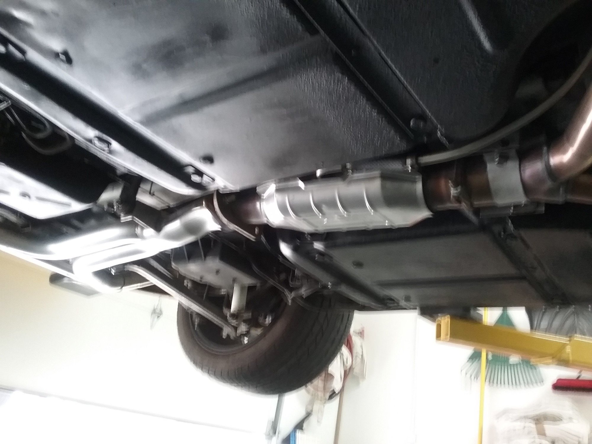

Default C4 with No Mufflers - Inspector said get Mufflers Quick!
Car came from Colorado with no mufflers. Here are pics of the underneath exhaust. Don't know what type of exhaust is on it now. He said cats are descent.
I'm not sure I'm going to keep the car as I want to try it out for a month.
But I need to put some mufflers on it and not sure whether to put Magnaflows on it or Stock Mufflers or Cheapies(probably not even if I sell it later).

Well if I'm understanding this correctly I think I've decided to go with MagnaFlow with the black tips like are on the car right now and if you noticed the right tip is a little crooked it just looks like it was welded on crooked so I'll make sure they straighten that out when they attach it to the new Magnaflow. I have to keep the cats as it is a state law.
I'm sure not going to go with chrome tips of any kind with tinted windows a black stripe and black wheels.

if you're replacing the entire system, I suggest a walker OE replacement system, however, upgrade to the 86-91 design (w/ catless, pre-cat front y-pipe). the mufflers (quietflow's) have dual functioning tips. not sure why they're called quietflow - they have a good, deep tone, that rivals my corsas. they are not-in-your-face loud, and don't draw too much attention, but just a good sound, just a little louder than stock. I went with a walker OE replacement on my 85 and couldn't be happier. total cost (from summit racing) around $550-$600.
