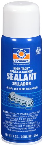

I wouldn't use RTV to hold a gasket, I use -
I spray a coat on the VC flange, and a coat on the gasket, and assemble. I don't use anything on the gasket-to-head surfaces. BTW, I only use this with aluminum head small blocks, and fel-pro silicon gaskets.
