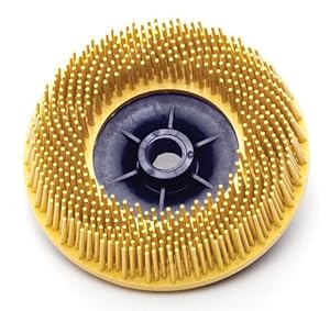

Finally got the heads off what is the best way to clean the block deck wire brush, sand paper, scotch bright pad?
This is the best way to do it
3M Bristle Disc
There are three wheels; yellow, white, and green. I used the green for mine.
3M Bristle Disc
That's pretty cool. I haven't seen those. Looks safer than the 3M scotchbrite roloc discs as I know that you can gouge metal off of your deck surface with too aggressive of an application.
