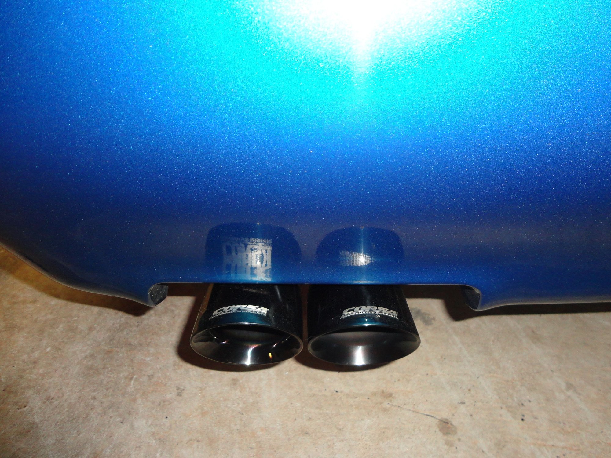

My new Corsa Cat-Back System
Already explained my long PITA issue with Magnaflow.
Today I got The Ghost back on the road, and this exhaust
system impressed me.
First I took few shots of the whole system because this system
is brand new based on the stickers on it. It is also different from
other Corsas I've seen, and others pictures posted in here throughout
the years.
This system was a breeze to install. It was so damn easy that I
stopped because I thought something was wrong. Nothing was
wrong, what happened was I was not wrestling with this system l
ike I used to do with that POS magnaflow. All bolted in place,
nothing rubs, and the O2 bung was in the right place, and in
the right angle. This is one of those times that it really shows,
and feels that you do get what you pay for.
-Here the system looks identical to all those posted here before.
-This is a big deal for 96 Vettes. If that bung is not in the right
place/angle it would create trouble, and you would have to plug
the original, drill, and weld a new one.
-Here it is, this muffler is actually not like other Corsas I've seen. Look
how the main pipe is thru, but there is a new chamber that connects
the mufflers with the second tail pipe.
-I bought that jack adapter long time ago, and now I can use it. I could
never use it with the 3" tubing.
Here it is how it sounds at idle, and at 70 MPH.

My Corsa muffler, has that extra pipe feeding the muffler chamber and the insides of both mufflers tips have the slot cut outs just like your pictures...
Is the pipe circled in white, what you're referring to?...
I guess I can not see inside the muffler, but ; Do you have those four holes on the inside? I have an older ZR-1 set, and they do not have them.
Yes, the four Slots are also, present on the Inlet side and inside each tailpipe.
