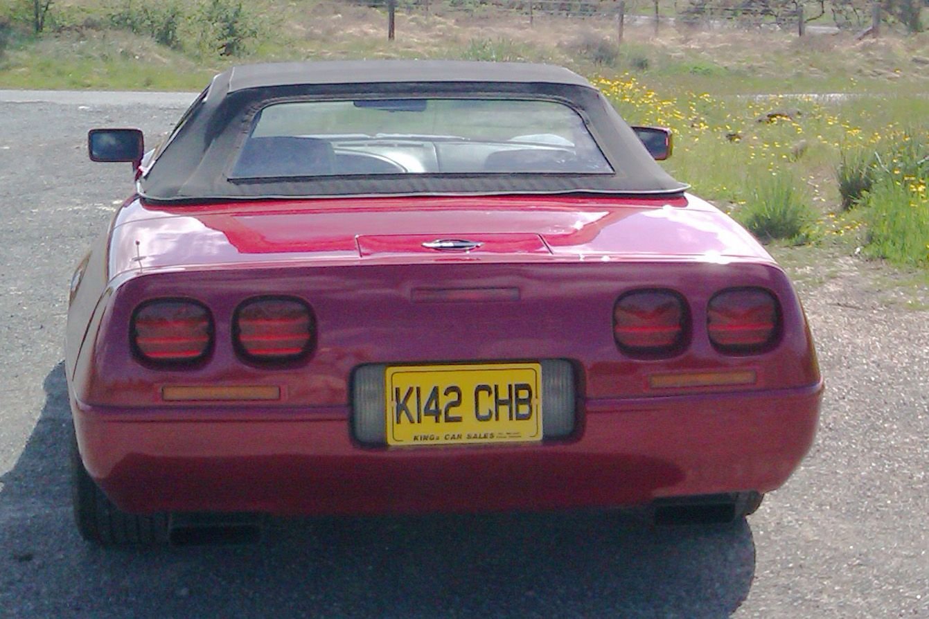

I'm in the UK, and my car was sorted as follows. Rear indicators; the previous owner fitted extra rear indicators as shown in the photo. Alternatively, you can buy amber rear lenses, and rewire the lamps to work as you need them to.
Rear indicators
At the front, I replaced the original headlamps with UK spec Halogen units from Keith at Eurovettes (it had Japan-spec left-hand dipping sealed-beams, so it dipped correctly, but the light output was CRAP!!). The new lights have a proper lens and H4 bulbs, and are great. They also have sidelight bulbs built in. It is a fairly easy job to find the side-light feed to the orange lamp, and cut it. I made up 2 little looms to feed the supply to the headlamps, but was careful to attach it carefully leaving enough slack for them to rotate. The only thing I haven't solved is how to get round the fact that the lights only rotate when the headlights are turned on. I just turn on headlights, and back to sidelights. I hope this helps. My m.o.t. tester was happy tp pass it anyway!!
