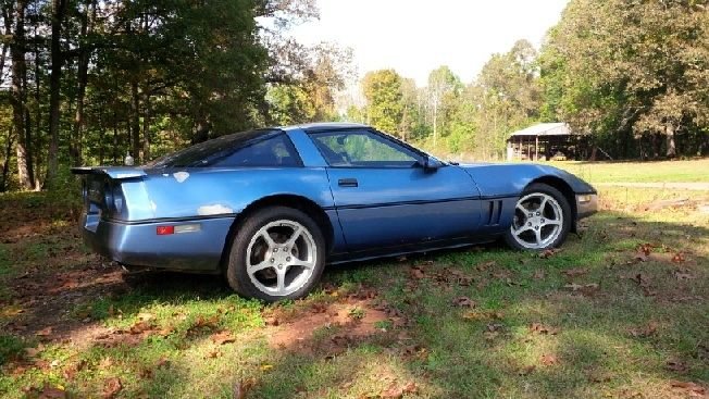

What are the best adapters for this setup

What year car and what wheels do you have mounted? You asked for help but in this particular case the "picture ain't worth squat".
Are the 17" and 18" C5 OE/GM or replicas OR what?
Sorry sir.
1985 and original C5 wheels

If they're 8.5 @ 58 for the fronts I'd buy 33mm for the front and if the rears are 9.5 @ 65 I'd do 27mm for the rears. That would place the wheel tire in nearly the exact same placement as the 9.5 @ 38 of the '85 Z51. That would be ideal I believe for appearance.
If you wanted to get close to those and the adapter/spacer is only offered in SAE dimensions buy 1 1/4" for the fronts and 1" for the rears. That's close enough. Be sure to buy adapter/spacers that are hub-centric to both the car and the C5 wheels. That's a 70.3mm wheel center bore.
Your C5 wheels should have the specifications cast into the rear of them - I'd check that and post back before buying anything to confirm.
