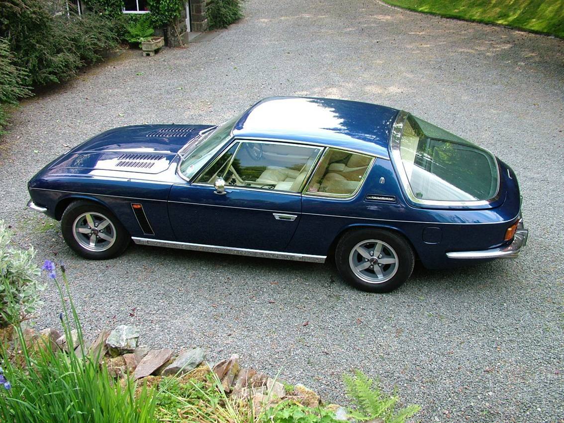

Originally Posted by pavesema;
The break pedel is also hard to push down. One thread suggested: [B
"Has the brake booster ever been replaced? I'm asking this because there's an adjustment for the push rod length on the brake booster that's quite sensitive. A couple of turns the wrong way and you get brake drag when the brake fluid heats up.[/B]"
That could be it. Many years ago I replaced the master cylinder on my Jensen Interceptor. Being a very low volume British car, they used parts from all sorts - Chrysler Motor and Trans, Austin front suspension, Jaguar rear axle. The brake system was Jaguar too, so I used a Jaguar part (it was cheaper!). My pedal felt fine but the more times I braked, the harder the brakes remained on. Turned out the push rod was a fraction too long. I cured it by grinding a few millimetres off the end. Hope this may help.
