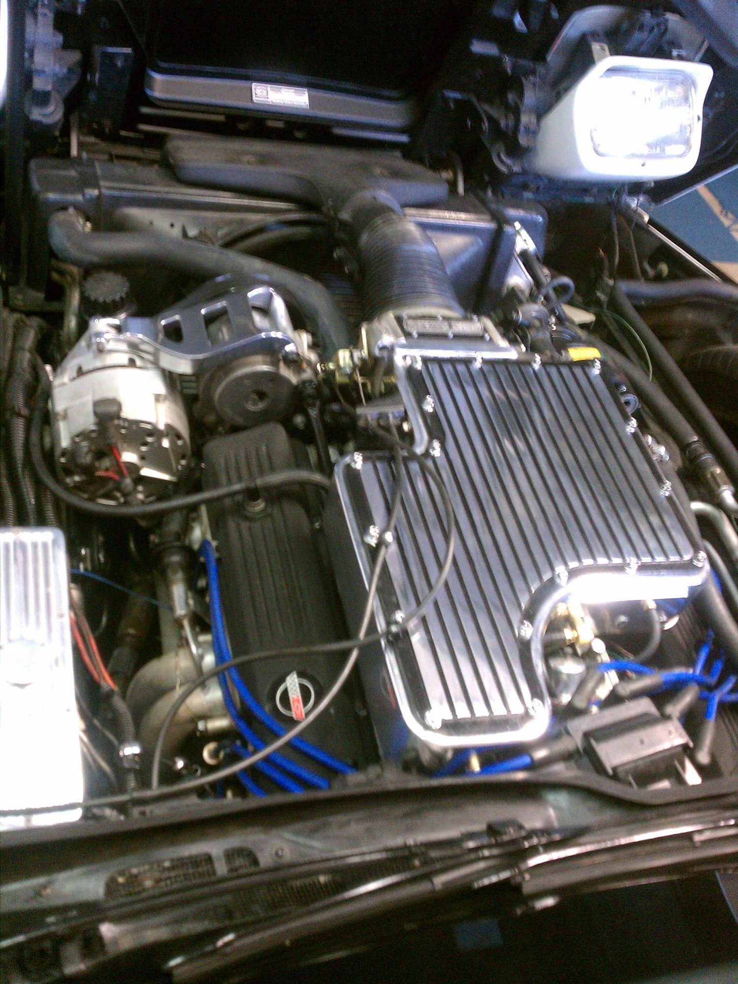

I'm liking the newish ceramic paints, from DupliColor and maybe others. I have used the clear over polished aluminum, with good result but haven't shopped satin black.
Proper prep work will allow good adhesion, as with any paint, so ensure all oil and wax is removed and at least scuff with ScotchBrite or something.
