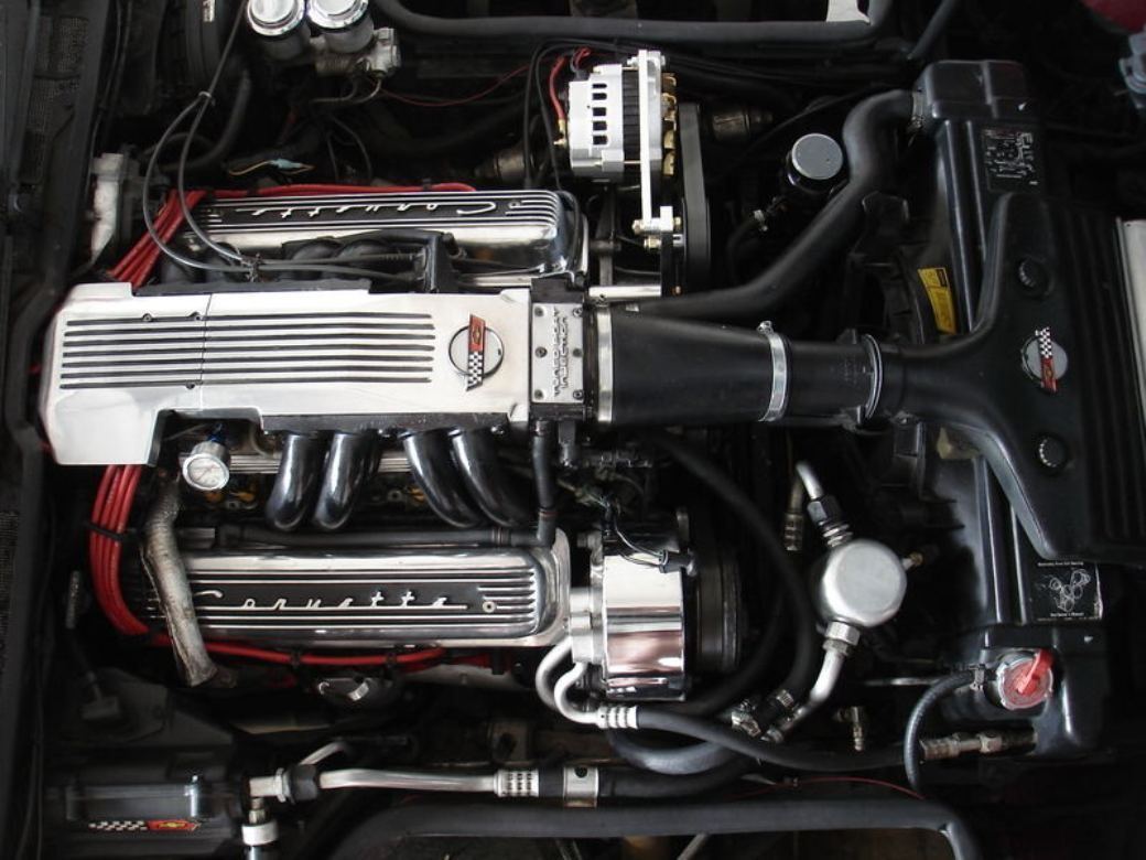

They look great on a L98

Old Sep 5, 2014 | 05:58 PM
floridamale's Avatar
floridamale
Joined: Jan 2008
Posts: 3,939
From: Vero Beach Florida
Originally Posted by jodester
question for Floridamale
Love the looks of those valve covers. Were did you get them?, brand?
Check the link in Bandit's C4 in this thread
Mine were polished then I painted the center part
I bought mine of e bay about 7 years ago
