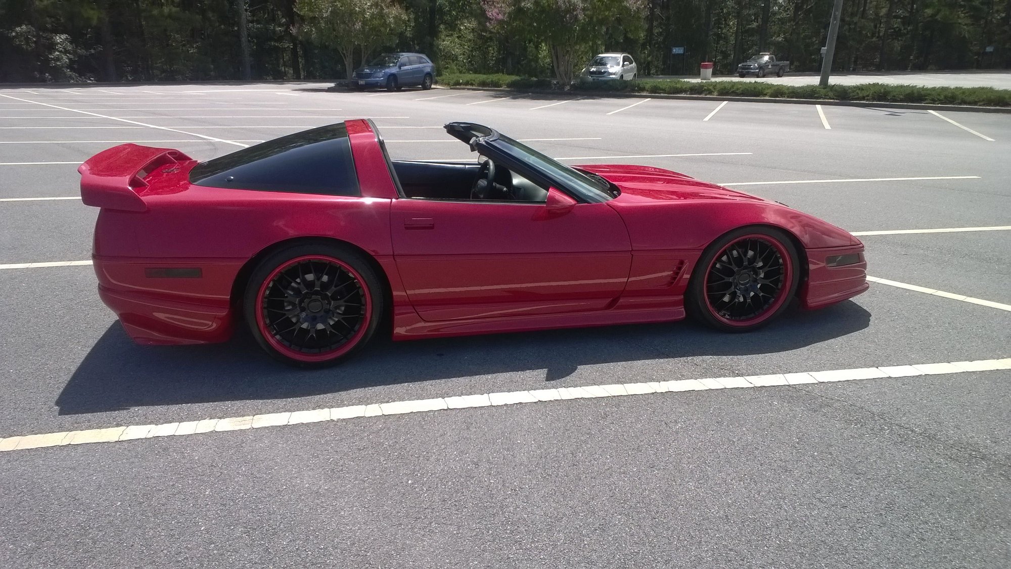

Here is an example of 20" staggered wheels on my Lowered 95. fronts are 20x8.5" and the rears are 20x10.5". running 245-35 up front and 275-30 rear.
With 373 gears and the rims my speedo is fast by 8-10 mph at 70.
