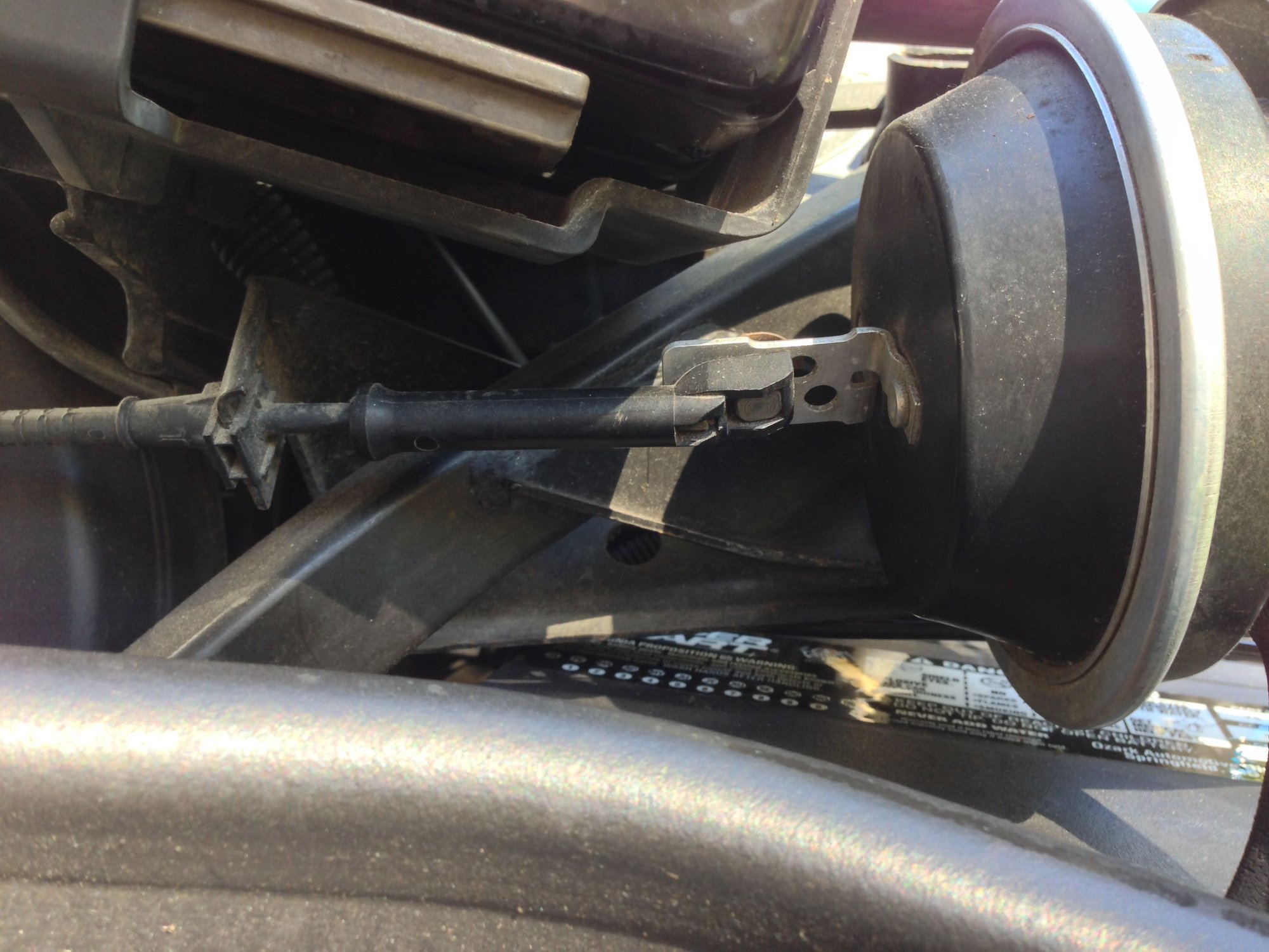

Can I get a picture of what you guys are talking about?

Here 'ya go!

This is what mine looks like

From the earlier posts they make it sound like their cable was too tight. If I am understanding this correctly, it appears mine is on the loosest setting. Could it be too lose?
What I understand is this vacuum diaphragm actually moves in not out correct?

Billy, from the beginning, I was wondering about the comment that a Forum member's cable was tight. Mine was loose, like yours.
But both extremes can't be good!
Go ahead and move the cable to a tighter hole (please, no XXX comments!) and test your cruise control.
