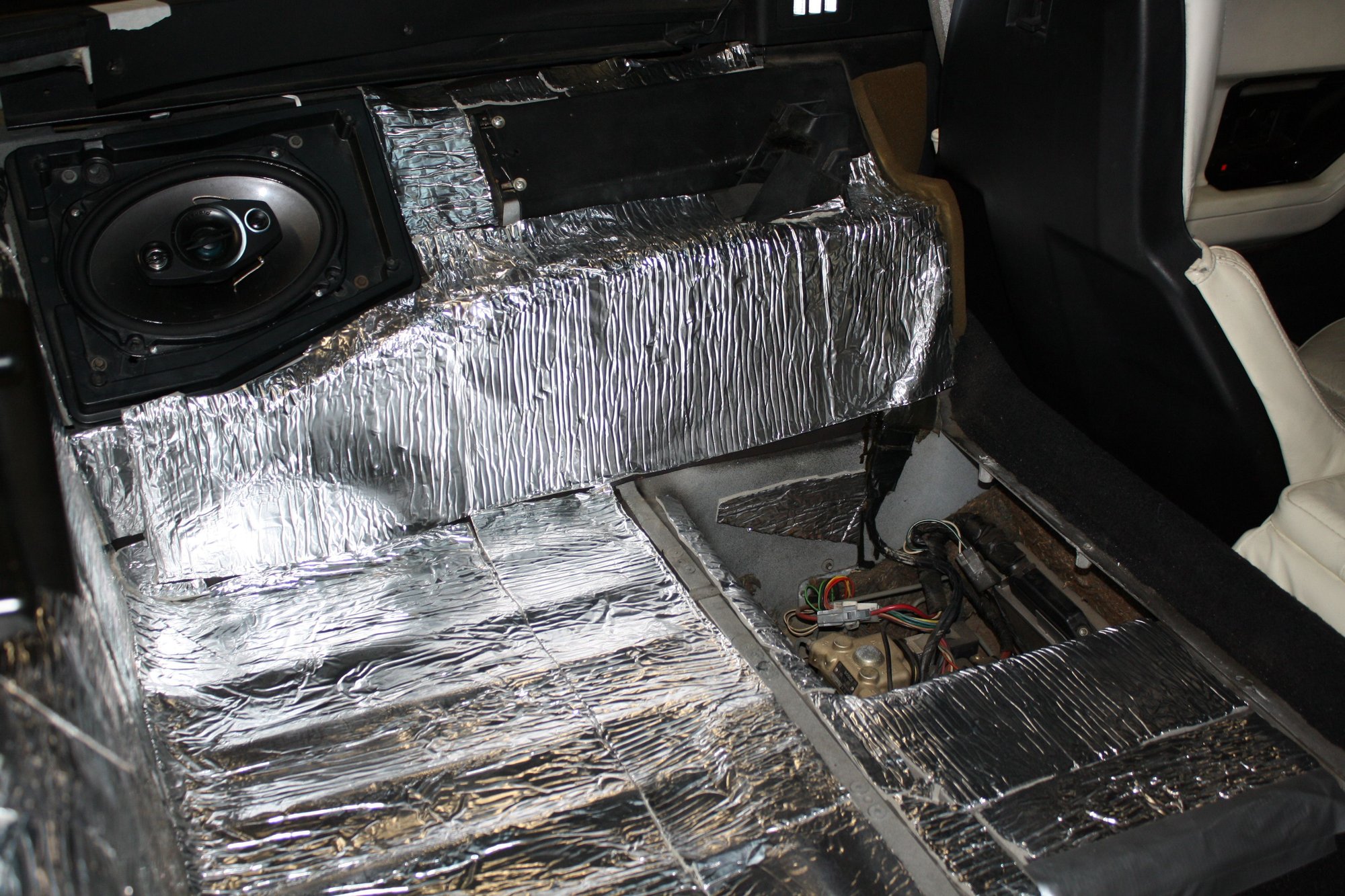

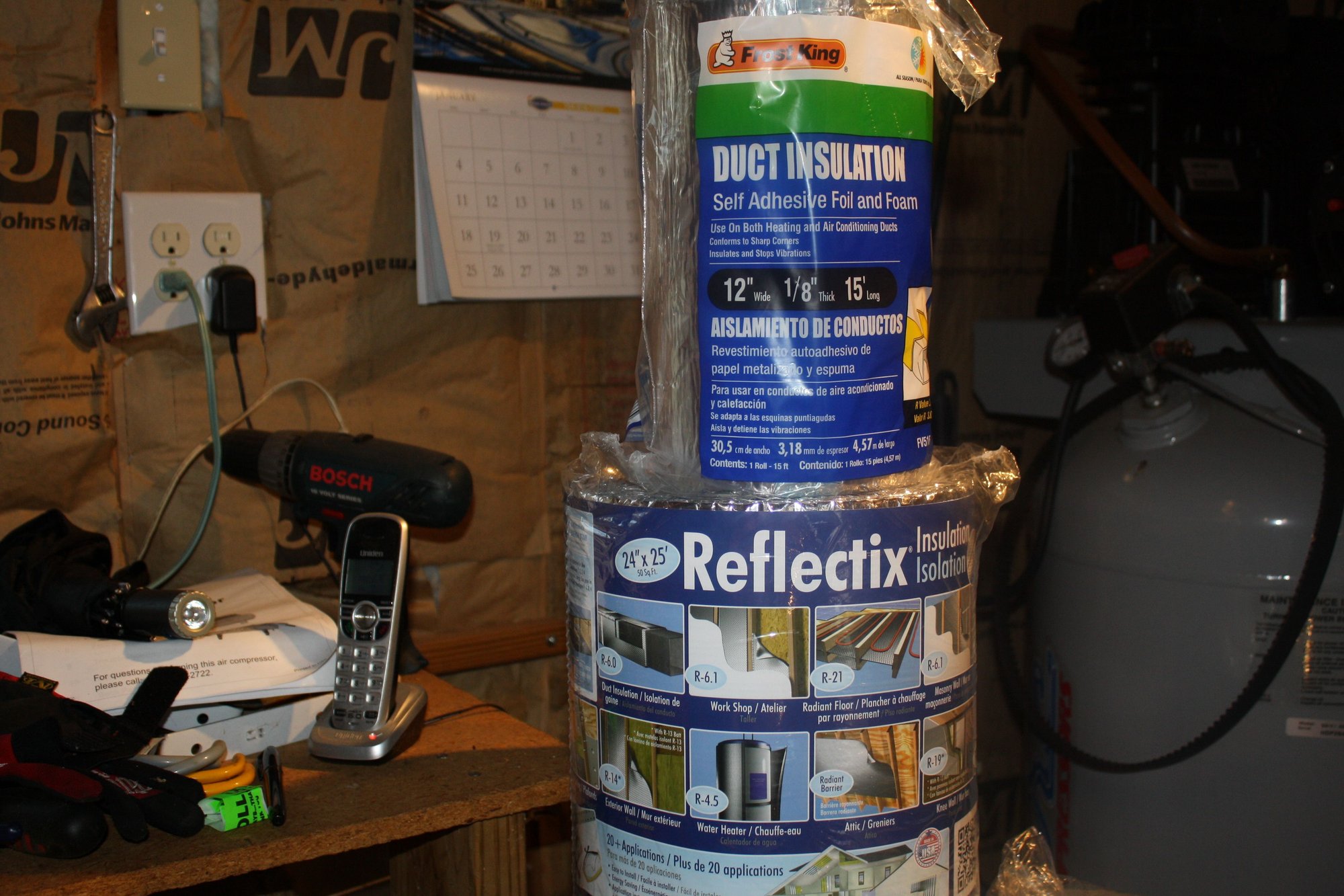

I used both these 2 products I bought from Lowes.
The top roll is peel and stick. The bottom is tiny bubble wrap wrapped in foil.

The peel and stick goes everywhere, entire cargo area and the deep wells, behind the seats, transmission tunnel, under and in front of the seats, and the inner side of the door sill. The Reflextic will not stick so I taped over most of the peel and stick. The new carpet will hold the Reflextic in place. I have not finished the doors. I will only use peel and stick on parts of the door where it will stick and not interfere with the door operations.
Does it help reduce heat and cut down on noise, I’ll let you know soon. I just installed new seat cushions last week and have not driven the 88 on the road yet.
I used 3 rolls of peel and stick and the one roll of Reflextic. Cost was less than $100.

I used the Frost King Duct Insulation everywhere. I used it on the door side of the door panel. It is a little thick. So it was tricky to get the door panel back on. But boy, what a difference.

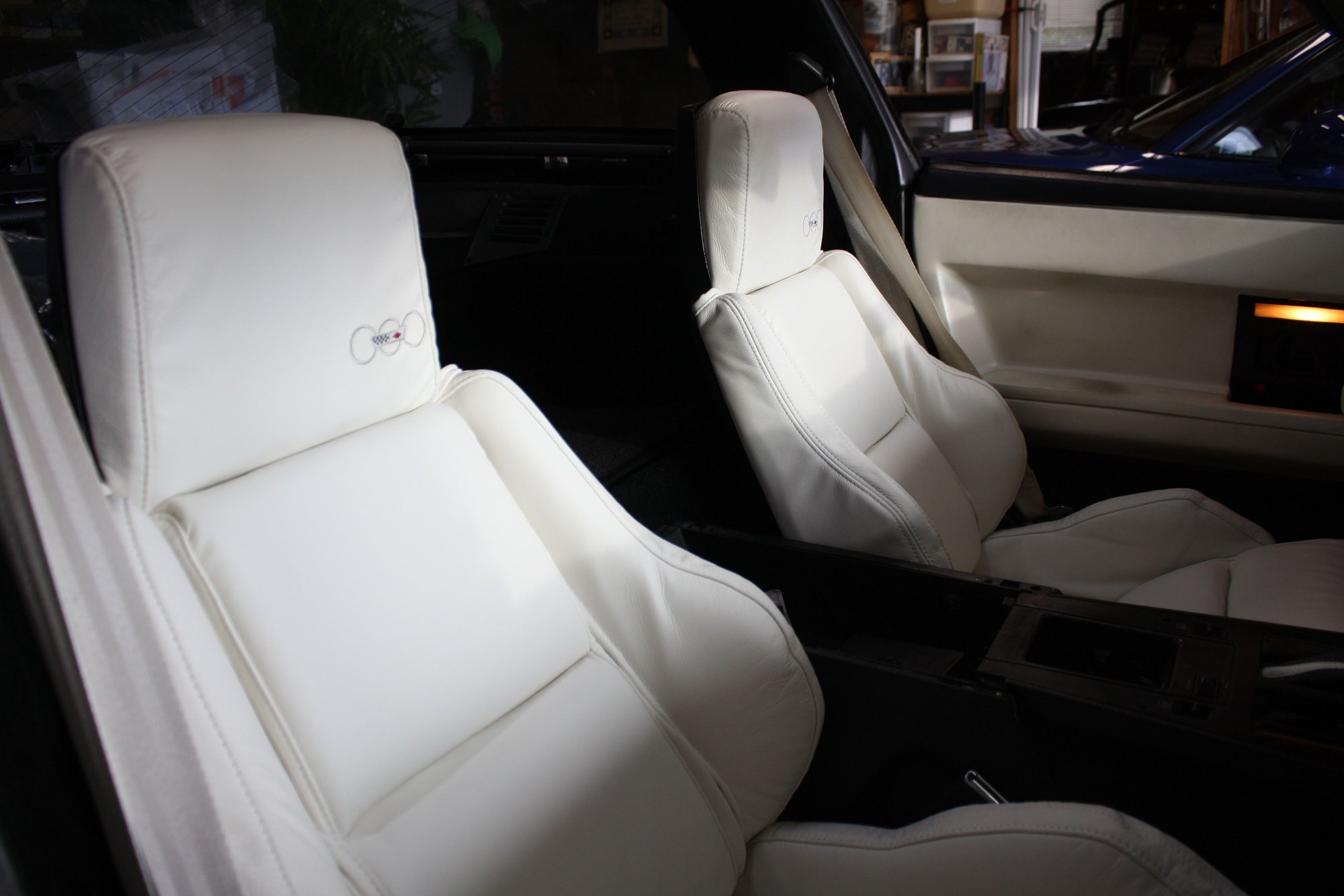

Newly installed 35th white seat covers and foam. These seats will never be any whiter. New seat foam is the greatest. I had some problems installing the carpet and seat frames because of too much insulation. I don't want to repeat the same problem with the door panels. Thanks.

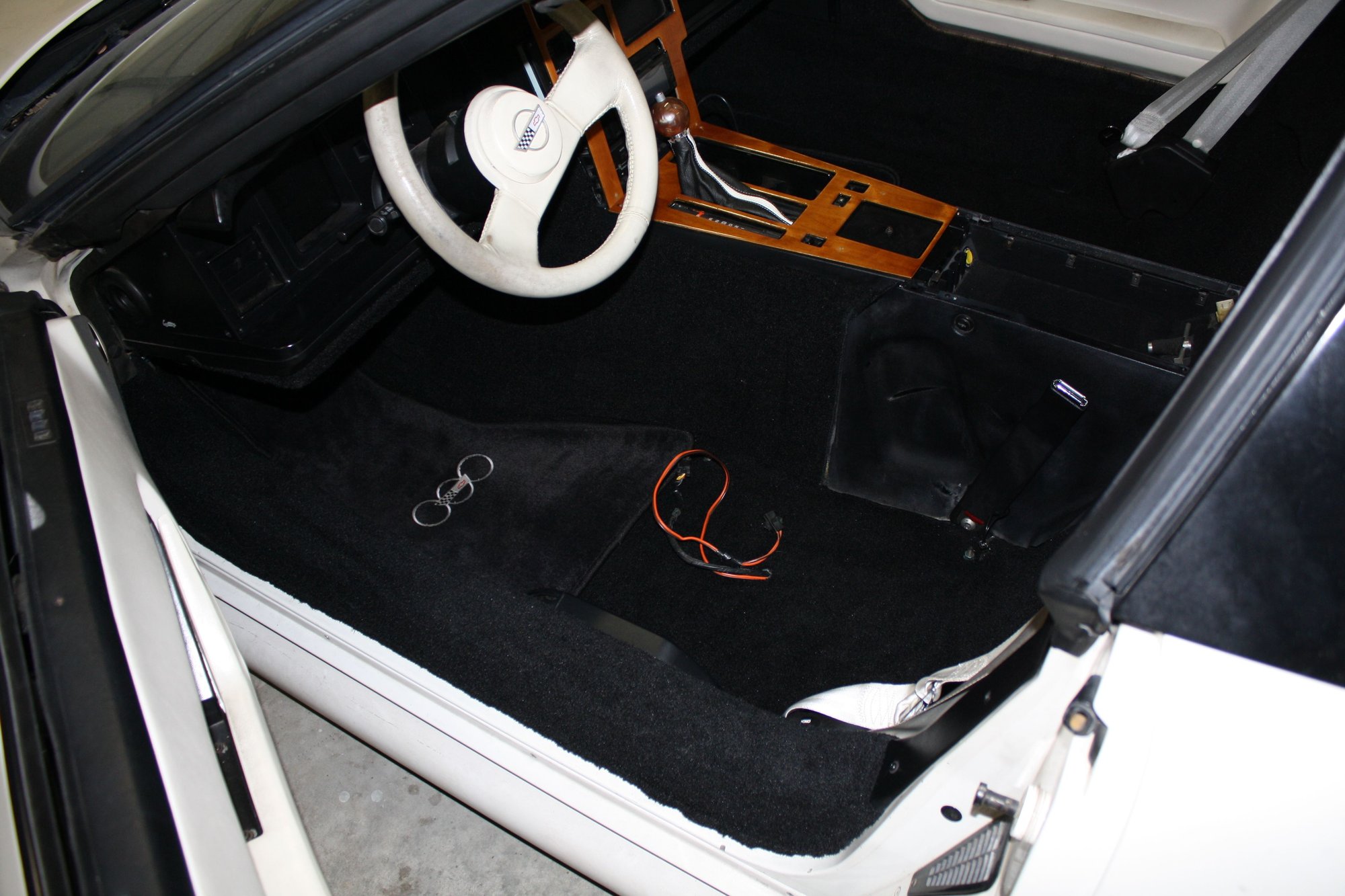

I pulled 90% of the old foam and old jute and threw it away. Put new insulation in. I installed carpet with mass backing which is nothing but a heavy polyethylene plastic coating. Need to use a heat gun on this stuff to get the carpet to lay where you want it. I spent all my winter weekends doing this.
I need to re-attach the ECM plug in above the driver side right knee and hood latch trim and I am done. Except for the doors.
