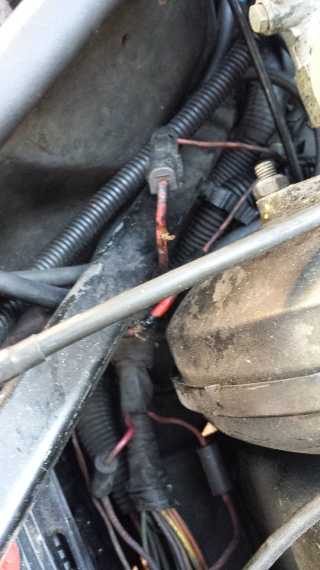

Need4speed1984's Avatar
Need4speed1984
Joined: Aug 2013
Posts: 47
I found them and noticed tape around each one...could this be the problem?
Old Apr 25, 2015 | 06:59 PM
Need4speed1984
Joined: Aug 2013
Posts: 47
It was the link while I was checking those wires the wire fell right out of the rubber...I wired it to the 12v line (temporary) and the fan kicks on at 200 and the temp went to 206 then down to 185. Thanks everyone save me a lot of time and money!
