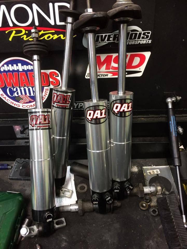

Does anyone know if the Doug Rippi Coil overs will work with QA1 single or double adjustable shocks?

I wouldn't think so. That kit requires the creation of a snap-ring groove on the shock housing to locate the sleeve for the package. Any vendor should have a package that can be added to their shocks and I'd stick with their offerings. Some of them offer a coil-over with a spring of less OD than the DRM spec which is required for the 46mm shocks like the Bilstein.
I believe the reason why you see "no package" from any/most vendors is that if they market it in a package then there's the "liability" issues for all. If you understand shocks you should be able to assemble a package of your own and if you present questions to QA1 or anyone they'll generally respond with all the information that you need. Mention a particular application and they'll likely not want to make recommendations.
I had a list of part #'s for a C4 QA1 package at one time and I had a new complete package that I sold.

So I need a 46mm Shock? I am in the process of buying a set of the DRM coil over and a friend has some QA1s he is offering for a good price.
If the QA1s don't work how do I determine what shock will?

Im rethinking this, I might be better off with the QA1s and a drop kit.

I mean the QA1 shocks and a drop kit.

The problem is I dont want to spend 2k
I have a line on a set of DRM coil over W/O shocks for a good price and a friend is offering the QA1 shocks. At this point I'm not sure what I'm going to do.
I do have my stock Bilstein shock..its a possibility i may give them a try.

You need the Guldstrand adjustable sway bar end links in the front and you will have to modify your top rear mount in order to fit the Rippie setup.
For the Van Steel, you will still need the adjustable end links most likely.
I run the Van Steel kit. It's nice and worth it in my opinion. My car was Z51, so I don't think that it "handles" any better with coilovers around corners, but it rides so much better and still corners the same.
You can send your Bilsteins back to the factory in California and they will cut the snap ring grooves and rebuild/revalve for you for not very much money.
If you can get the Rippie kit for a decent price, I would go for it. You may want to look at Coleman Racing though... I bet you can get it cheaper there than you will used.

Thanks for your help guys. After thinking about it I decided to refresh my whole suspension with Poly bushing and a lowering kit. I also bought Double adjustable QA1s for the rear and single for the front.

Just for info what part numbers are the shocks you bought ?
Rear TD512
Front TS511
