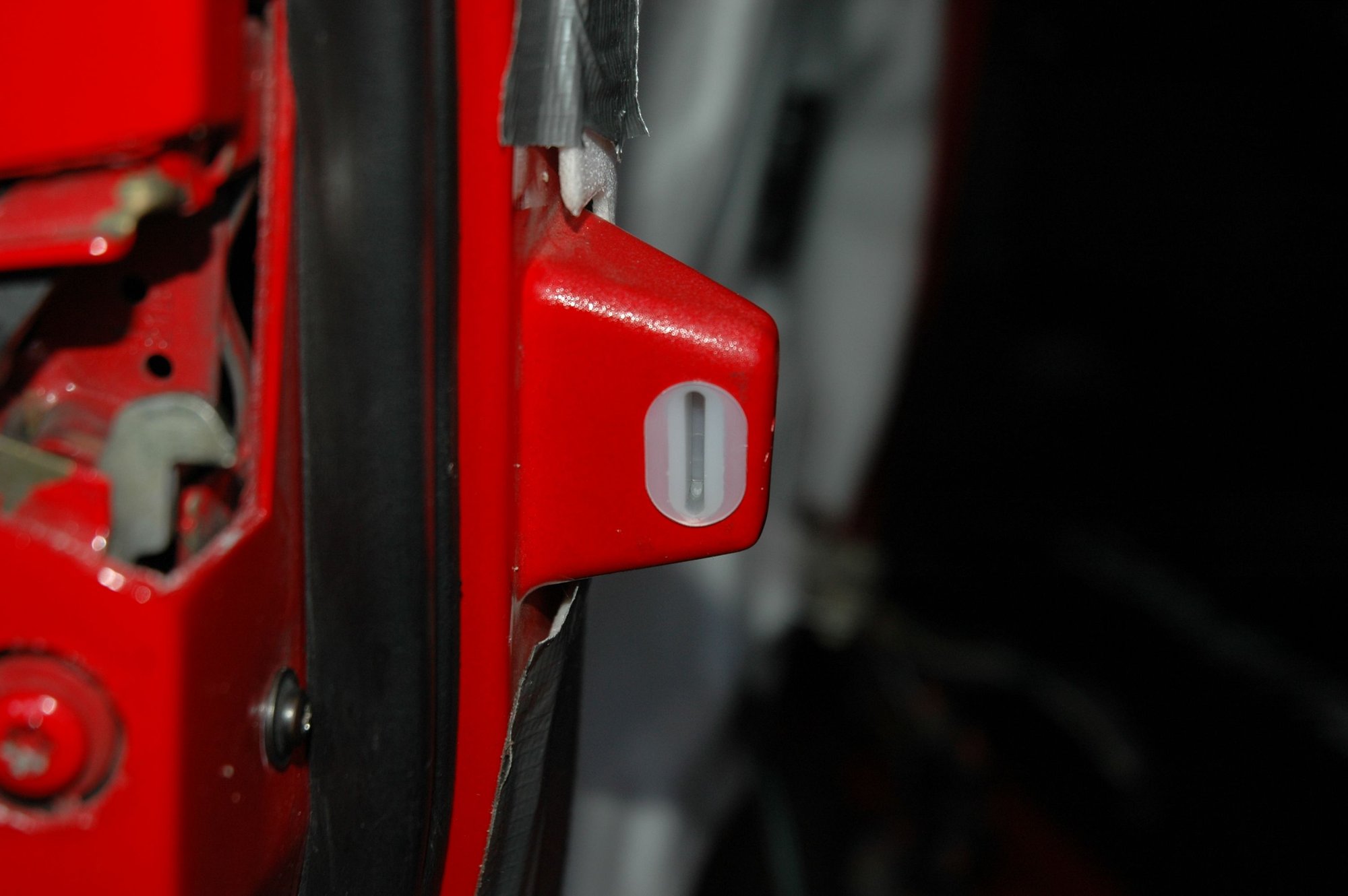

About a year and a half ago, I decided to tackle the broken ribs in the door panels of my 96.
I too had the gap at the back of the door between the panel and the door structure.
So after I repaired the ribs I noticed a tab at the rear of the door structure that could be used for an attachment screw for the door panel.
I went to Lowes and found a plastic insert that fit in the slot in the tab and an automotive screw and washer. After I got the hardware installed, for me it looks like the screw should have been there all along.
Hope this helps.
Larry

Larry it looks great, do you remember where you found this part at Lowes?
They have bins just inside the main door of our Lowes that contain regular hardware (wood screws, machine screws etc). Among all those bins are some labeled specialty and/or automotive hardware. If you cant find it there, then look at one of the catalog websites such as Mid America Motor Works , Corvette America etc.
Larry

Default Door Panel Gap
I had the same problem at the top and back of my door panels. My fix was to trim the weather strip at the top/back that was holding the panel up. While holding the panel down and in I just put a screw through the panel and into the tab shown in the above reply. I painted the head of the screw black so you really have to look to see it. Total cost $.32.
