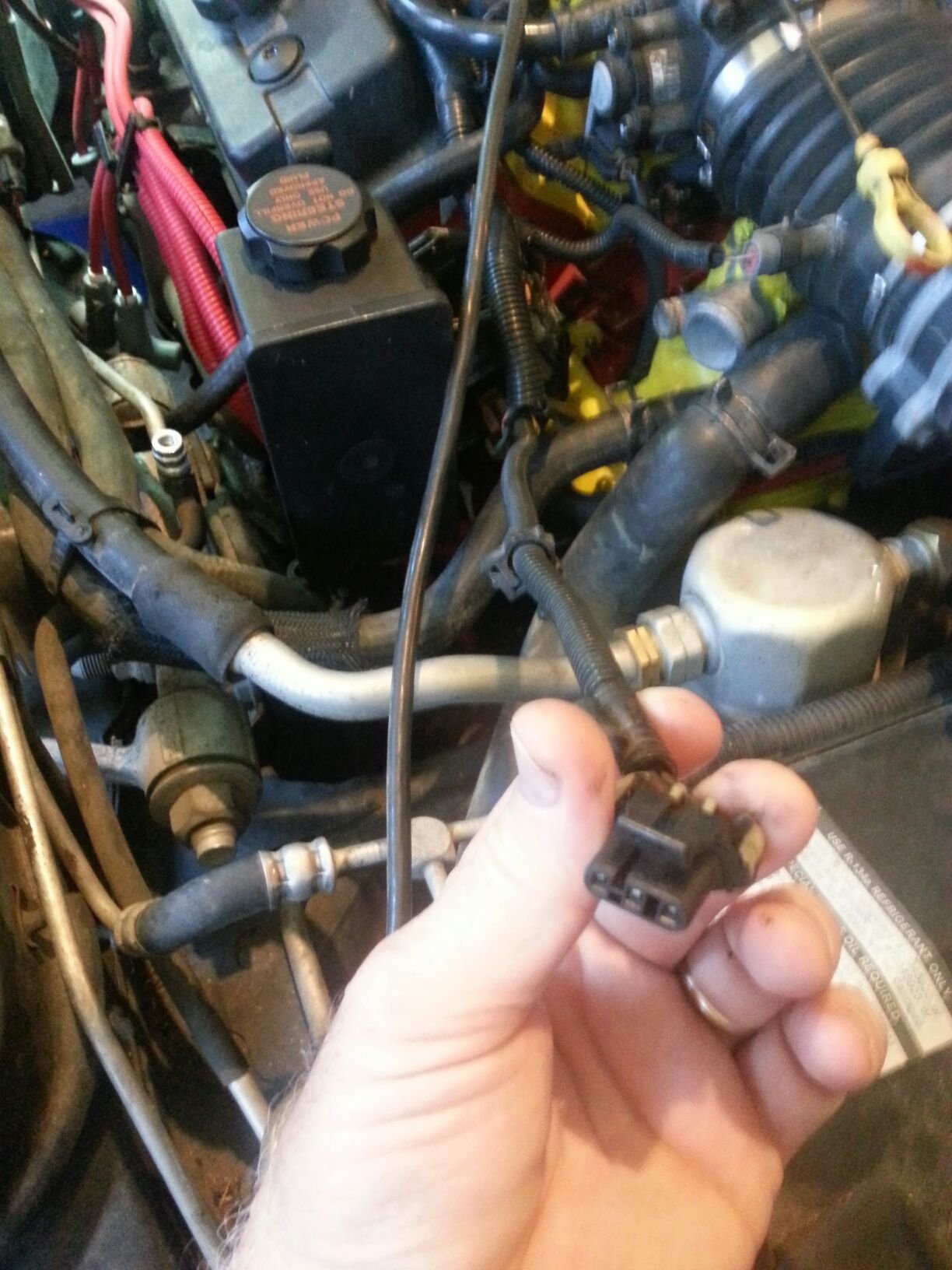

After engine rebuild I'm tying up loose ends. For the life of me I can't find where a 3-pin connector goes to. It's on the passenger side engine harness and breaks out with MAS, Coil, and water temp on water pump. Picture attached: it's long and whatever it is and wherever it connects eludes me and shop manual hasn't been much help.
If anyone can identify this and where it goes it would be greatly appreciated.

What year? If its a 96' could be your crank position sensor on bottom of timing cover.
BINGO! Thank you! Almost impossible to spot.
