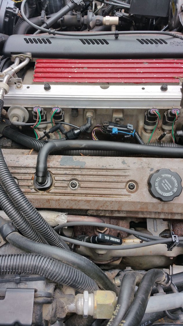

Hey All,
Should there be a PCV valve in the valve cover?
Mine has a straight hose in the cover (no valve).
I read some were it was under the fuel rail cover, but don't see it there either.

It's under the drivers side cover. In the side of the intake.

Thanks Onlyone.
It was in fact under the Diver side Fuel rail cover.
The U shape hose the PCV valve is attached to, was brittle and cracked while trying to remove.
The part appears to still be available through the dealership.
For future reference hose part number 10128361
