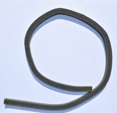

Daniel, I took a picture of the bottom seal on my old windshield.
The glass is face glued to a very large and uneven surface on the frame.
GM put a lot of sealer on the bottom to bridge all the gaps, and I had a heck of a job cutting through it all.
I would make a probe out of plastic sheet (or cardboard) and go along the bottom of the windshield to make sure they sealed it all the way across. Especially on the two bottom corners.
