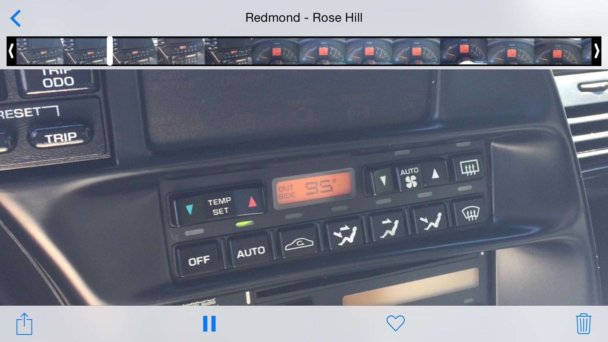

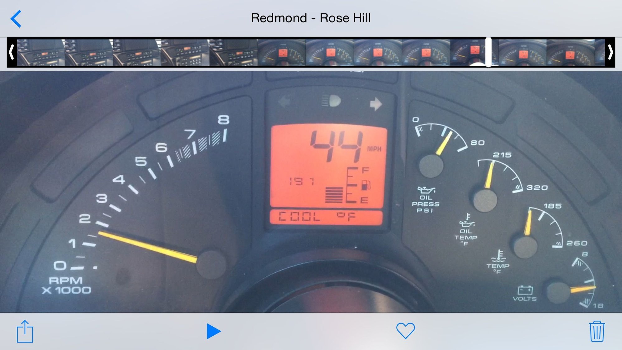

Ambient temp reads a little hot near the road surface, but I'm in Redmond and was out cruising earlier. 45mph Cruising and I sit at 196-198 with AC running. Hits about 210 in traffic. Car is tuned to turn on fan at 194. This is in my 96' LT4

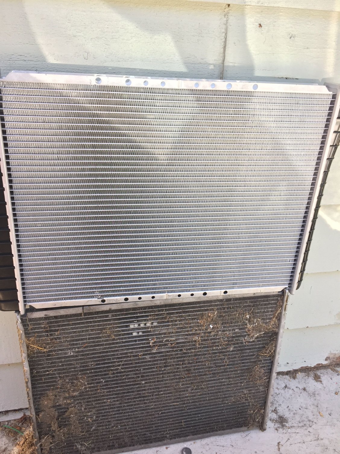

Before I swapped out the old radiator (shown below), I saw the temp get as high as 245 in traffic.
Last edited by HeavyLifter; Jul 3, 2015 at 07:43 PM. Reason: Added pre radiator swap picture
