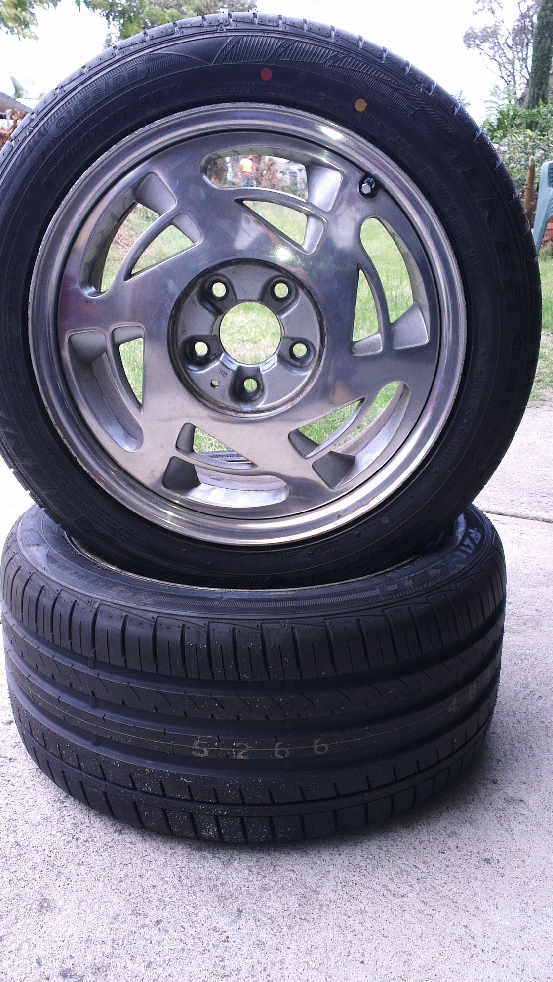

I drive a 1989 C4 and the last back tyres that i bought were khumos and within 5000 miles , they were bald . They are standard size . Just bought some new ones called falken . Those are the only choices of tyres anyhow . Just wondering what the average milage on back tyres should be really ? cheers
khumos when new

i was running 50 pound psi , and they wore in the centre the most . suspension is not worn , and had a wheel alignment done . Funny thing is that after the wheel alignment , the drivers door was rubbing against , fender and hood , so i filed it down until it cleared . And thanks for asking , cheers
the falken tyres
