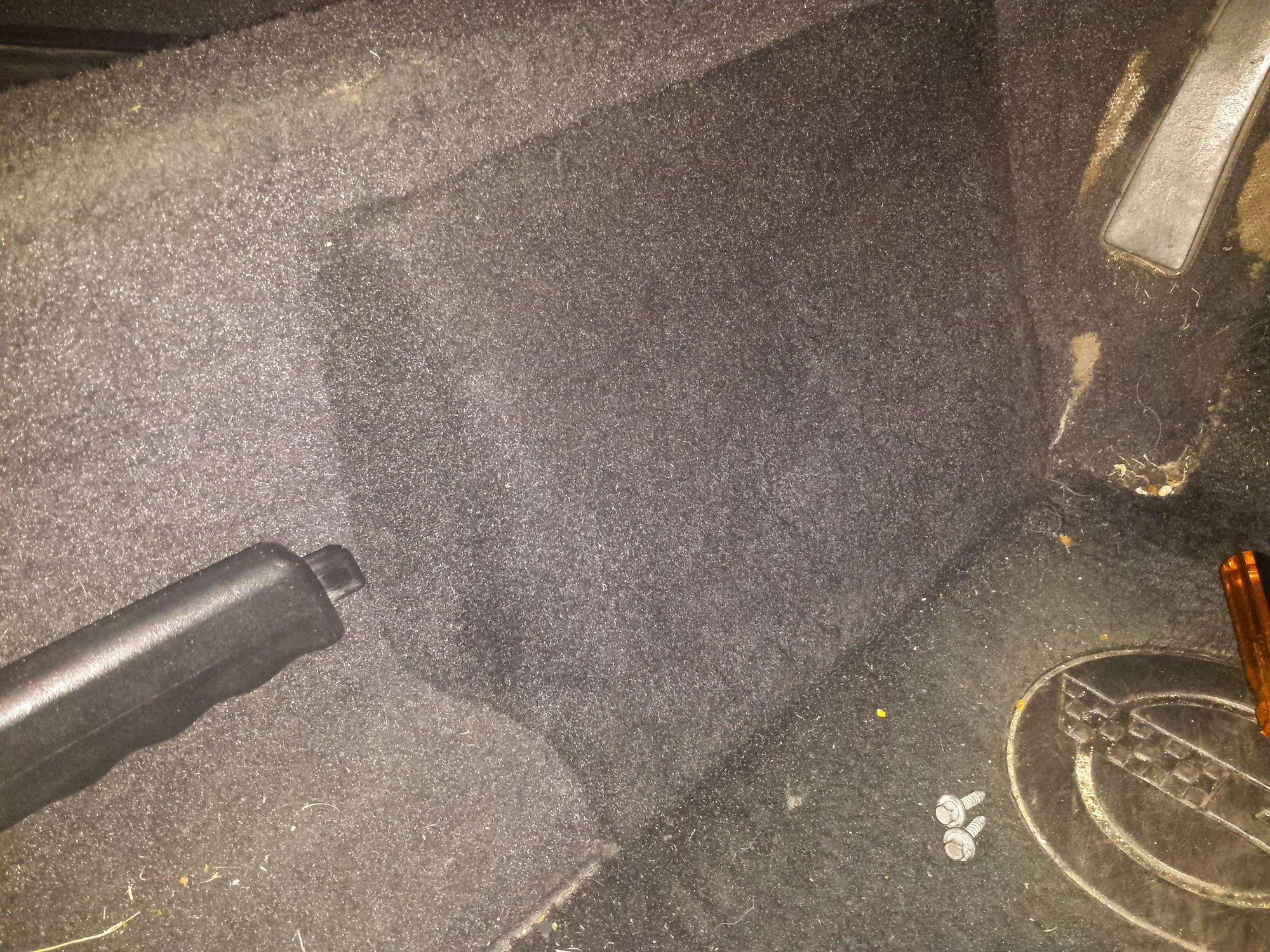

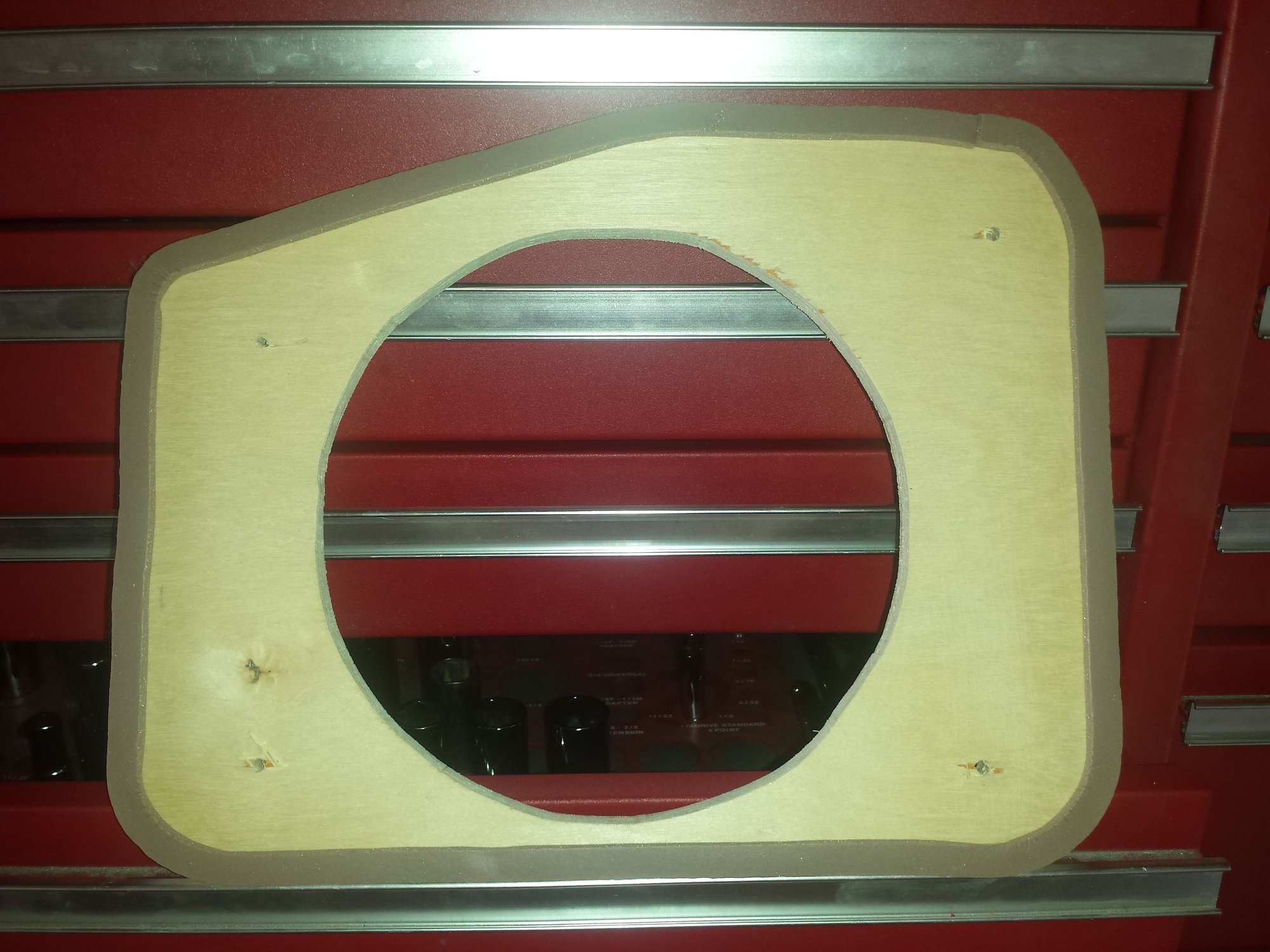

I have a 92 coupe and decided to replace the whole system. It had a Bose and the speakers were only about 4" so that took me on a quest to figure out how to get bigger speakers into stock locations. I tried looking for boxes for my year and nothing. I decided to make a 1/2" plywood plate for the rears, which are 8" subs but I'm sure others will work. I may add a port but waiting to see how it will sound first. On to the front. More difficult but ended splitting the two halves also mounting 1/2" plywood on the front so I could mount a 6 1/2" with a 1" tweeter componet speaker system. Works great, just have to seal it and maybe add a port to that also. I bought weather seal that had sticky on one side to seal the speakers. Everything looks stock.
