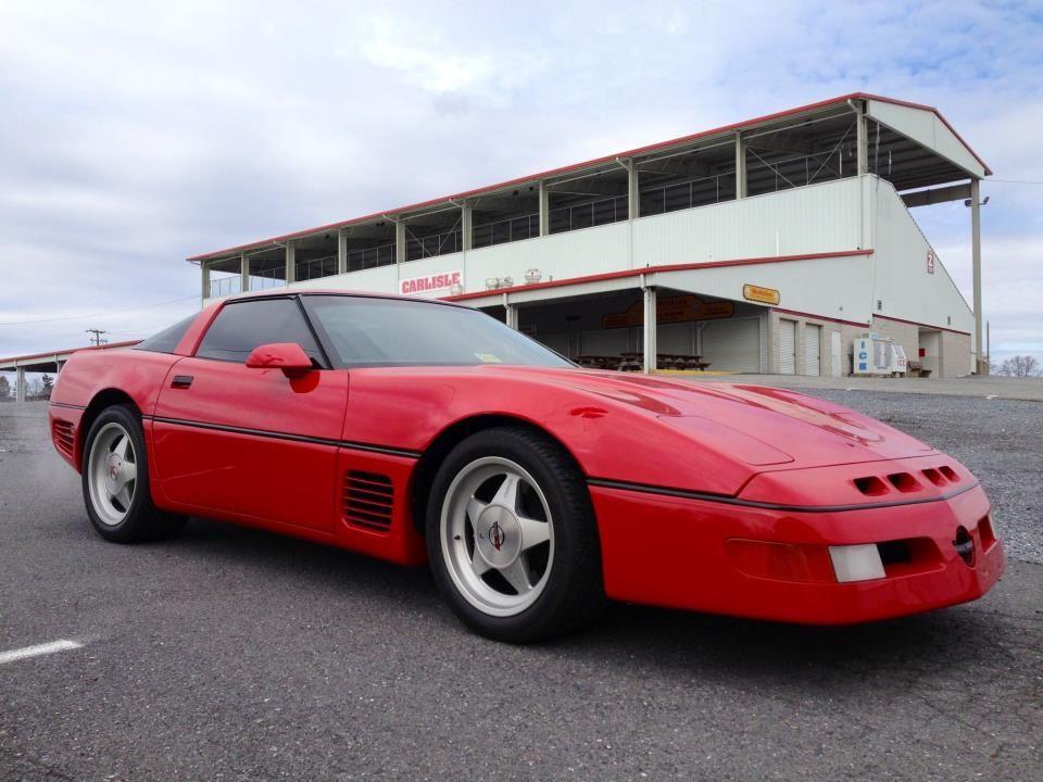

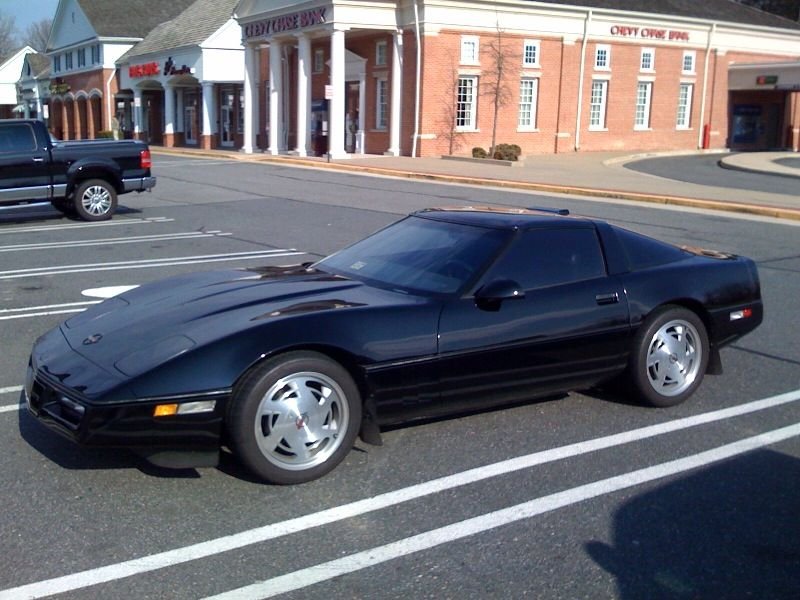

Beautiful cars! Thanks for sharing the pics.
