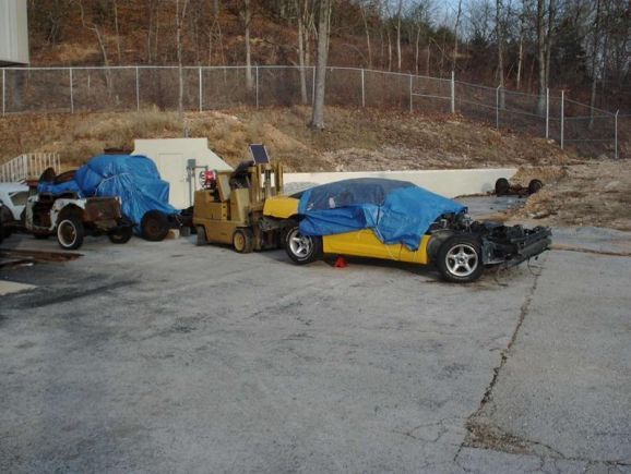

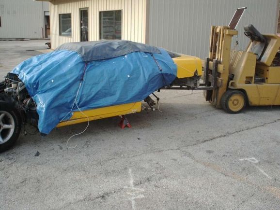

Hey guys!! Update. Please bare with me until we find out what this car really is.
I forgot about my photo album on this site! Pleas check it out there is a photo of the yellow Corvette right after I got it. In fact there are two showing the side rockers. Note there are NO bolt on stuff off of it. The rear bumper cover, tail lights and spoiler I took off prior to my unloading it off of the ramp wrecker as the driver's side rear hub was broken and folded under. This was when I was changing that hub assy. This car came sans wheels. The brake lite was smashed and I removed it also.
