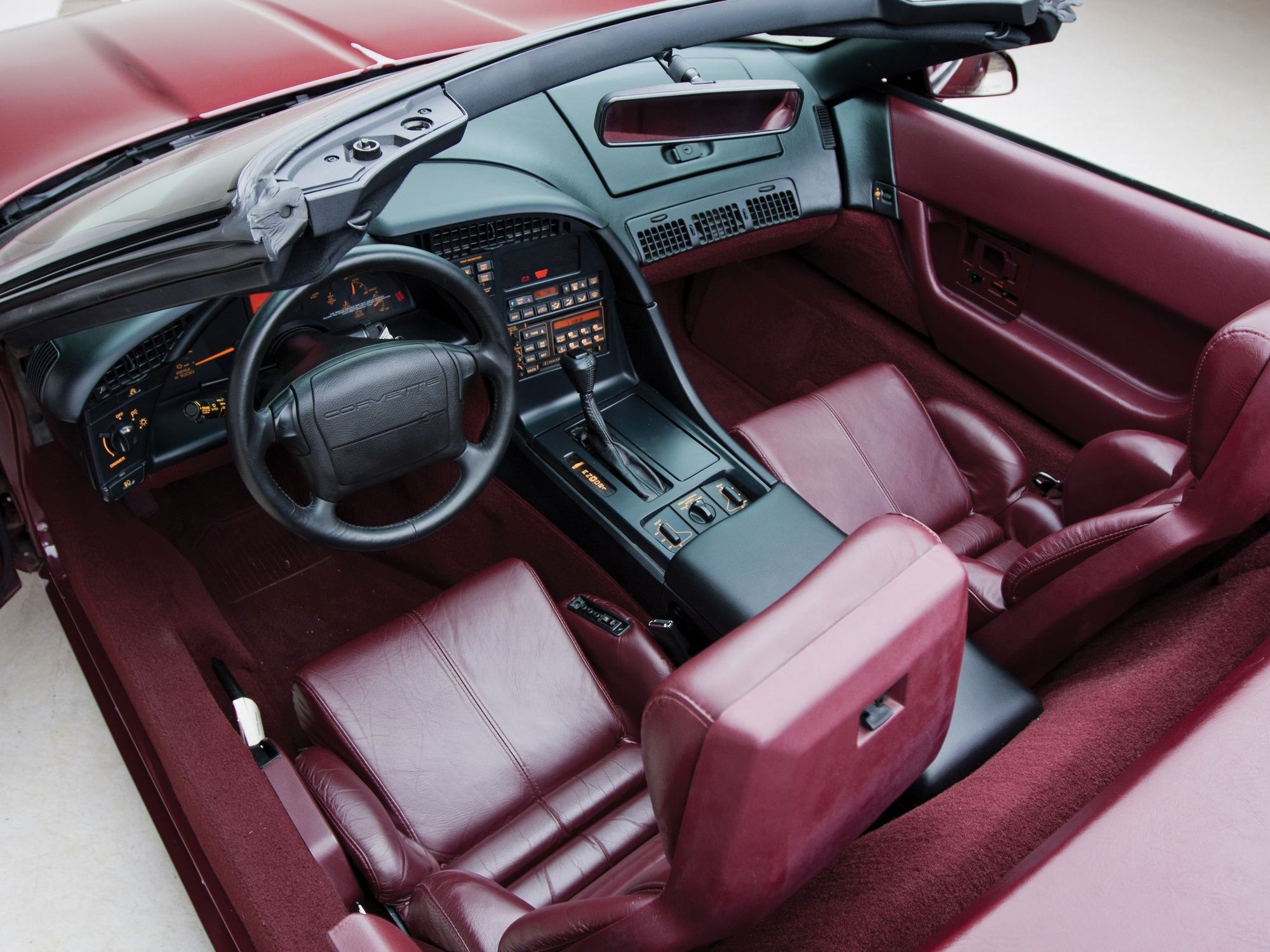

Did you get pics? If it looks different than this it is not a true Ruby 1993:
The last one is the Ruby that went into the sink hole. I took the pic in 2013
