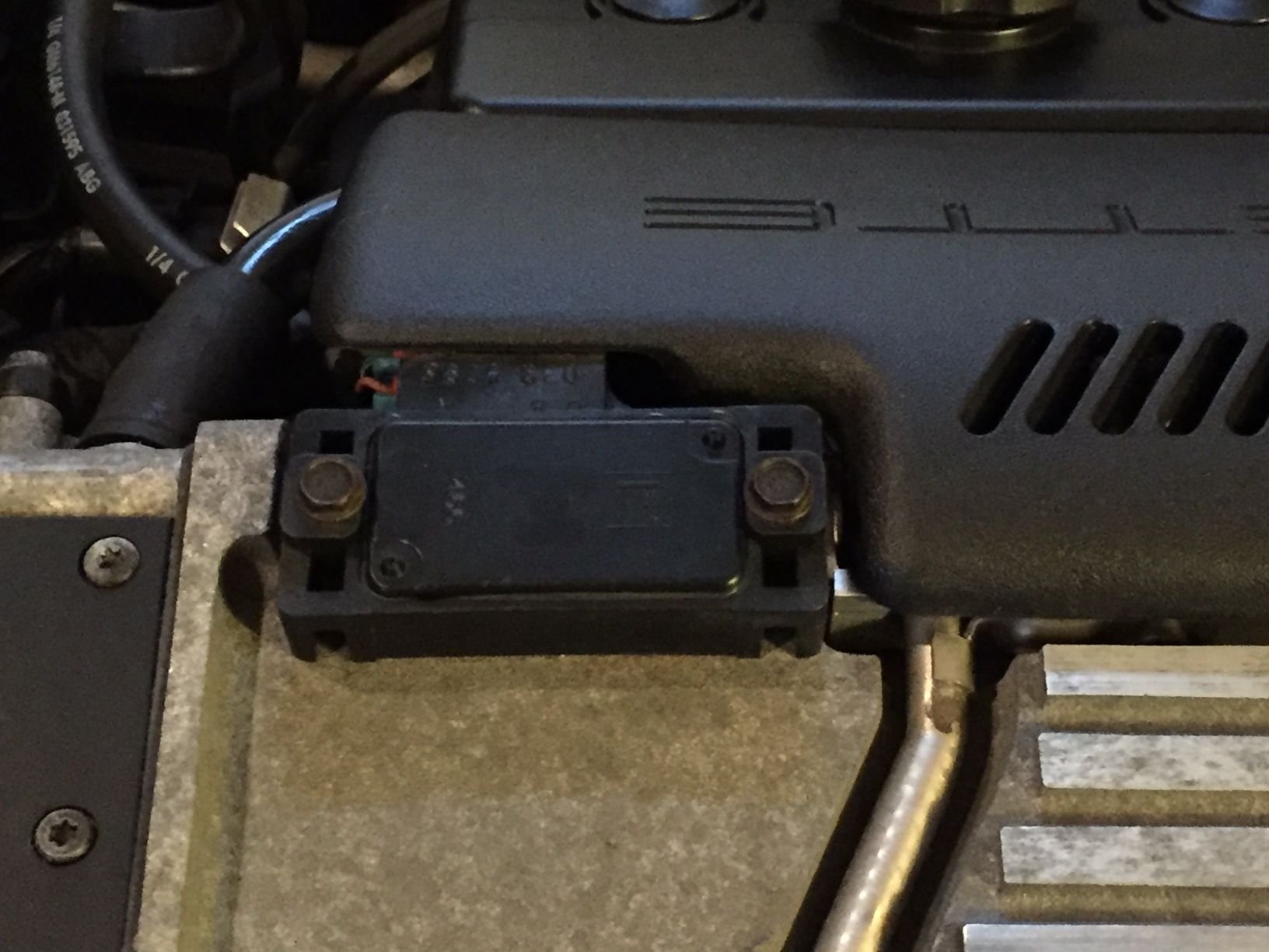

Need picture of where the MAP is located on a 95...Thanks in advance for any help.

Don't have a pic, but it's the black plastic rectangle thing on top of the intake. At the front, just behind the throttle body, on the passenger side. Two small bolts hold it on from the top.

its the black plastic sensor on the upper left most corner
I was looking on the firewall,,,Thanks for the photo.
