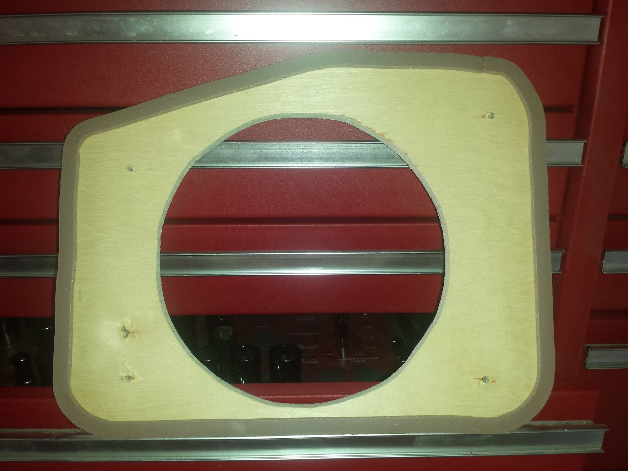

I almost went with that option of installing one in the storage compartment but instead made to mounting adapters from 1/2" plywood and used 8" shallow mount subs in the stock speaker locations. I get plenty of bass and used a 6.5" component speaker system in the front stock speaker locations. I used the back half of the enclosure and 1/2" plywood for those. All is hidden and there's no evidence of aftermarket speakers. It should be just a matter of making a template for storage component and fabricate one. Could make it out of a piece of cardboard and fiberglass for that matter.

So am I looking at this correct?
The first pick with no driver is the one for the sub?
The second pic is the front door with the components mounted? You sliced the BOSE enclosure so you could put a new top on it and remounted inside the door?
