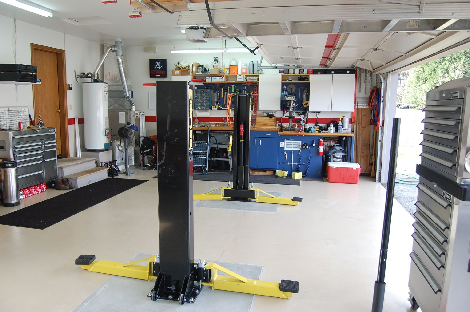

Here's my MaxJax install. I had to have new pads installed to support the posts as the concrete was only 2.5" thick and the specs called for 4".
I'm still using the small cart for the pump assembly and I'll be mounting it to a wall to keep from having to deal with the hydraulic hoses and connectors.
