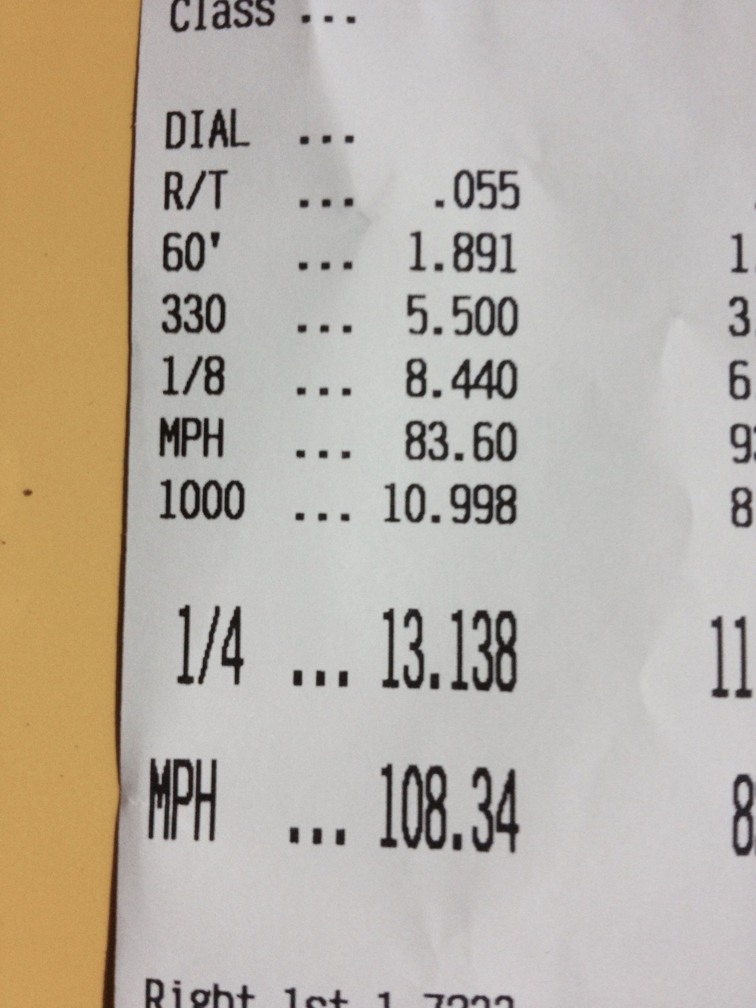

First run
13.13 @ 108.34
60' 1.89
I'd post pic of time slip but phone won't upload

Second run was slightly slower.

Darn good RT! That thing ran pretty quick compared to my L-98 (86). My best was 14.037 with street tires. Those new tires of yours help a lot?

The Nitto 555 worked good for me. I had no wheel spin leaving as had as I could. (Stock tq convertor). Just did a little burnout to dry off the tires.
The mods I have on this LT1 are 3.54 gears and a LE speced Lunati cam. .546/.565. 217/221 @050. Computer tune. K&N filter element. Stock exhaust manifolds and stock cat converters. Allens muffler eliminators. All else stock.
With light weight wheels I'd be in the 12's. Or a mild stall convertor.

that does suck; it happened to me as well and you're right-should never happen.
I upgraded mine to what I thought was a 96 model design that is made of metal vs. plastic; so I think anyway.......
well, good MPH and runs! Nice! not bad at all!

Headers,stall convertor, a 3.73 and MT Drag Radials with just bolt on's put my LT1 in the 12's @ 108MPH witch you already have so I don't think your MPH will change much you'll just get down there quicker.

Nice times. I agree a little converter would put you right in the 12's.
