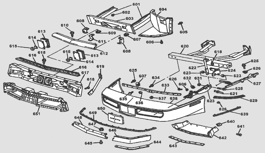

There are some adjustable braces right in the corner and just above the side marker light. #627-633
To bump on front bumper
