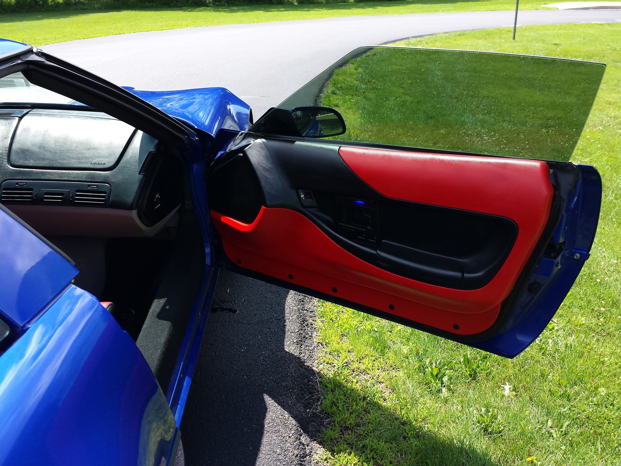

Here is a pic when i had 30%
A comparison. Perscription transition lenses are about 19%

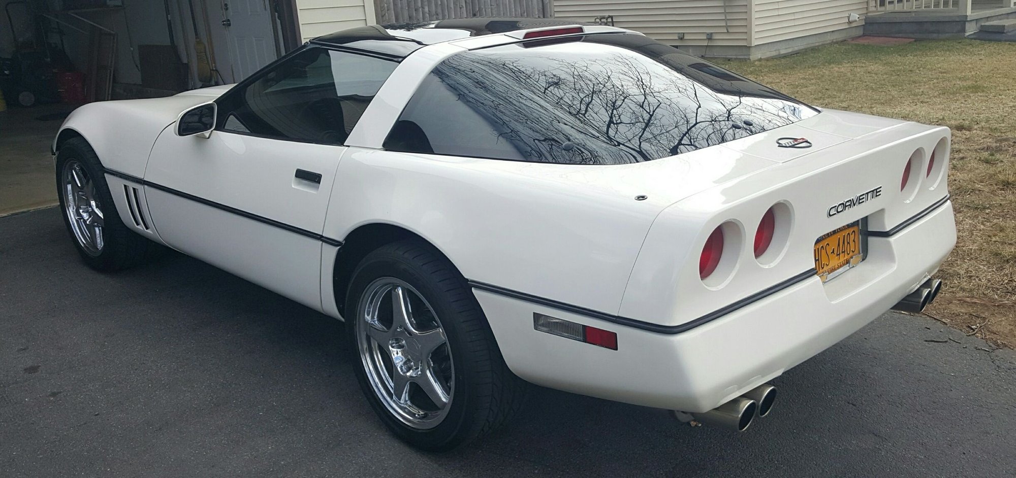

Here are a couple C4s I did last year, the red one is a 1995 with 5% tint and the white one is a 1984 with 20% tint
