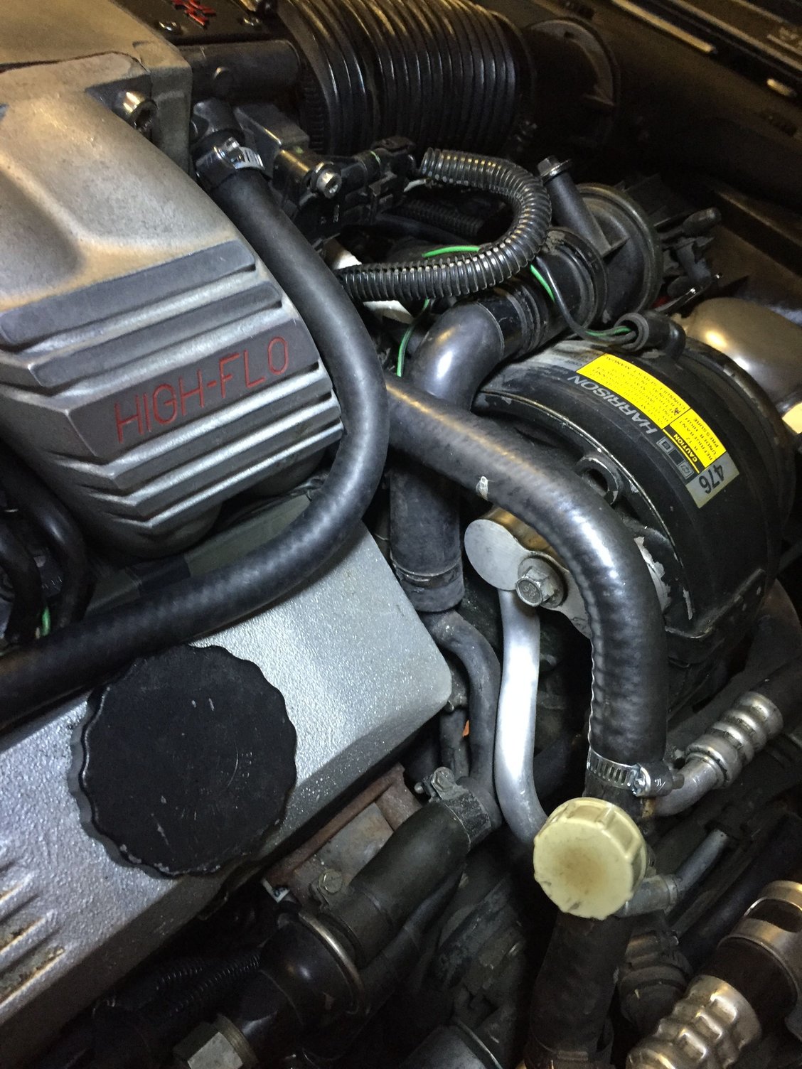

Size:  516.4 KB Air switching valve is on the left. Air control valve is lower and to the right. The red vacuum line connects them to each other.

Does that big hose at the end of the air Switching valve go to the exhaust manifold ?

Yes you are correct.

that explains it all I am not gonna worry about it then cause all that stuff has been disconnected the air pump is there for the belt only thanks for all the help this forum has done
