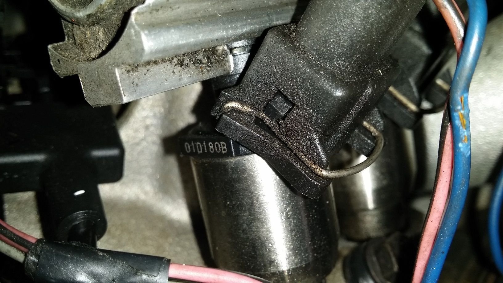

hello municipality c4
on my 1991 C4 Vette have been built by my previous owner new injectors.
Unfortunately I find on this planet, the data for these non nozzles
01D180B I suppose there are what Lucas named after.
durchfuß amount per hour and fuel pressure are not bad.
maybe someone knows of you these nozzles.
Thanks in advance.

Willkommen Sie im Forum.
http://www.smpoe.com/upload/SMPOE/Do...ellsheet-MAR15[1].pdf
this is about the only thing I've found on your injectors. hope this helps.
(Das ist das einzige, was ich habe auf der Injektoren gefunden. hoffe das hilft)

The injector body looks like a SMP (LUCAS) TRU-TECH and was likely the choice when the PO purchased. Maybe FJ47T? I believe so. The information on the injector is likely only internal identification or could be used/verified by SMP.
I'd think they were the FJ47T when purchased.
Here's maybe something for comparisons:
http://ecatalog.smpcorp.com/STD/#/ve...m/FJ47T?type=s
The link works but I'm not going to attempt any translations. Maybe someone else can help you with that.
Use the "button" CHECK FIT and you'll see how I surmised most of the info.
They could certainly be something other than, if the PO had modified the car but regardless I believe they're SMP (LUCAS)
