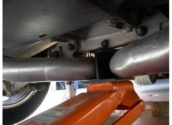

On jacking the rear of the car, the best way IMO is to use the Jackman adapter on a floor jack. It's basically a I-beam shaped piece of steel with a heavy rubber piece added to the top. It comes with a bolt that's used to bolt it in place of the cut on the jack and it fits between the exhaust pipes and raises the rear via the batwing:
The bolt didn't fit my jack, I added a piece of steel to the bottom that fit into the cup of the jack:

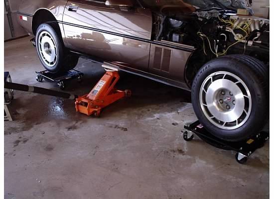

As far as supporting it on jack stands. You will find some pinch welded body seams just inside the jack points just in front of the rear wheels. Being careful to avoid the lines there, I made up some 3/4" pads with a add-on guide that fit the jackstands so they don't slide and use that when putting the car on jackstands. Put the pads there at those seams and slowly lower the car onto the stands with the pads between the pads and the car. Personally I leave the jack under the batwing so it's got 3 points holding up the car.
Front is much the same except I use the crossmember under the engine to lift the front of the car. You need a low profile jack to get under there.
That's pretty much it and how I do it. Hope that helps.
