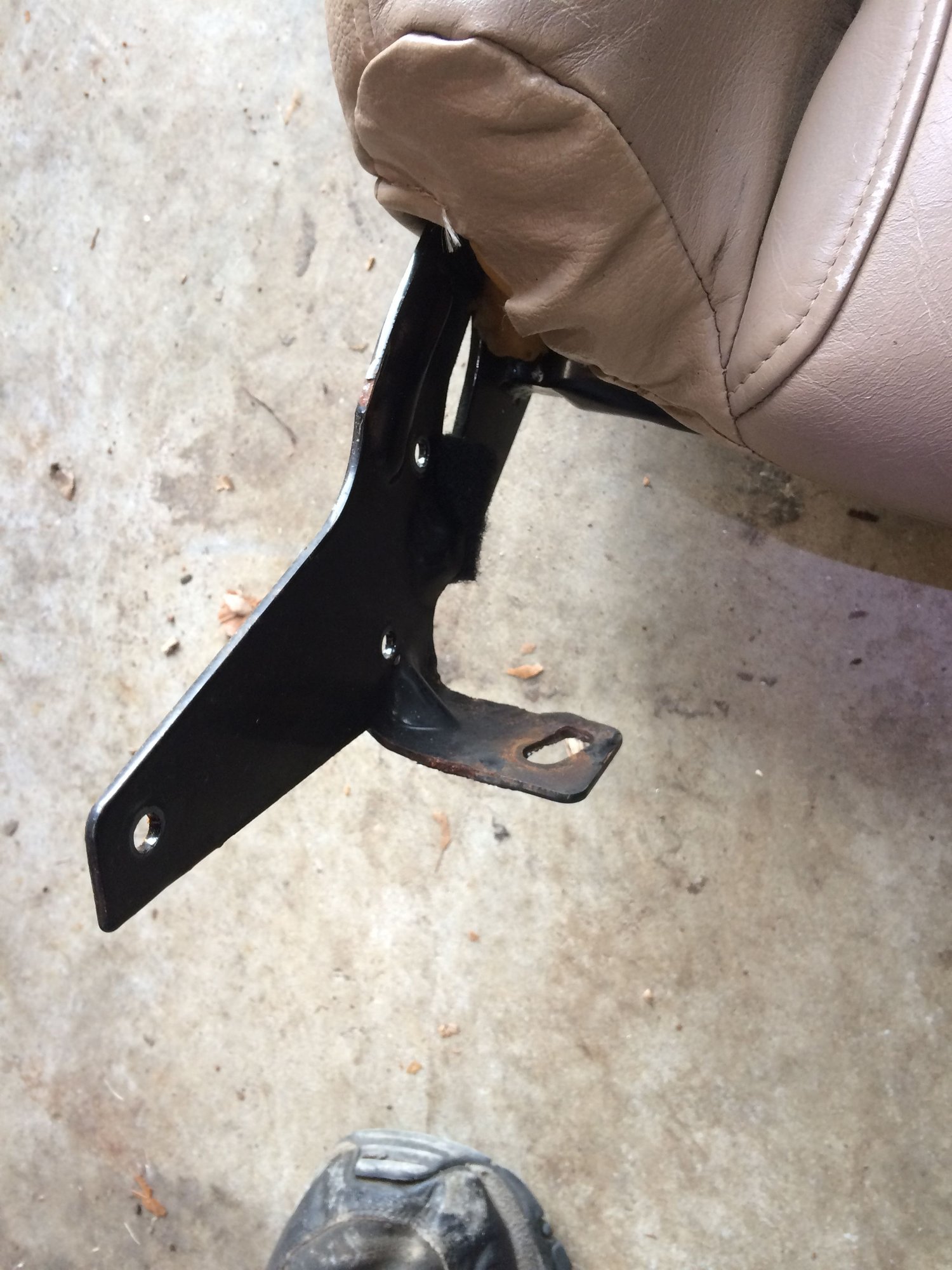

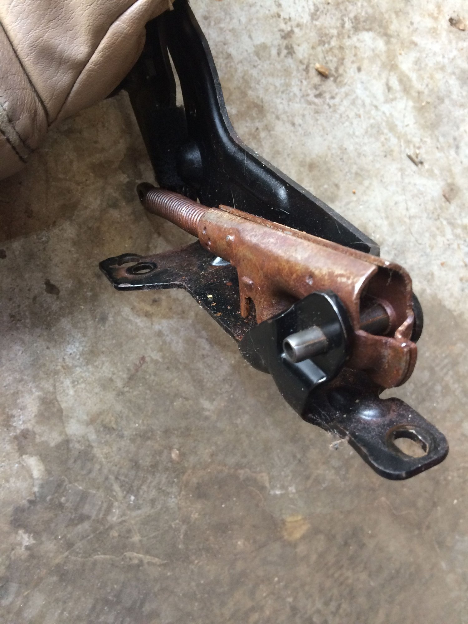

This is a simple remove and replace. Only two tips...take the pressure of the backrest spring by pushing the lever and letting the backrest go full forward. This will make it easy to remove the 13 mm bolt at the end of the spring. You need to do that to lift the adjuster up to unhook the adjuster cable. Secondly, the cable needs to feed into the adjuster through a slot that starts at an angle and then goes straight up.
I couldn't get a meaningful picture but once you look at it you see how the cable feeds in.

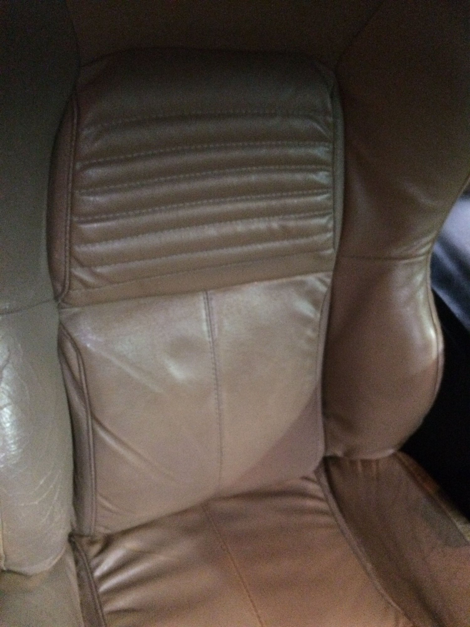

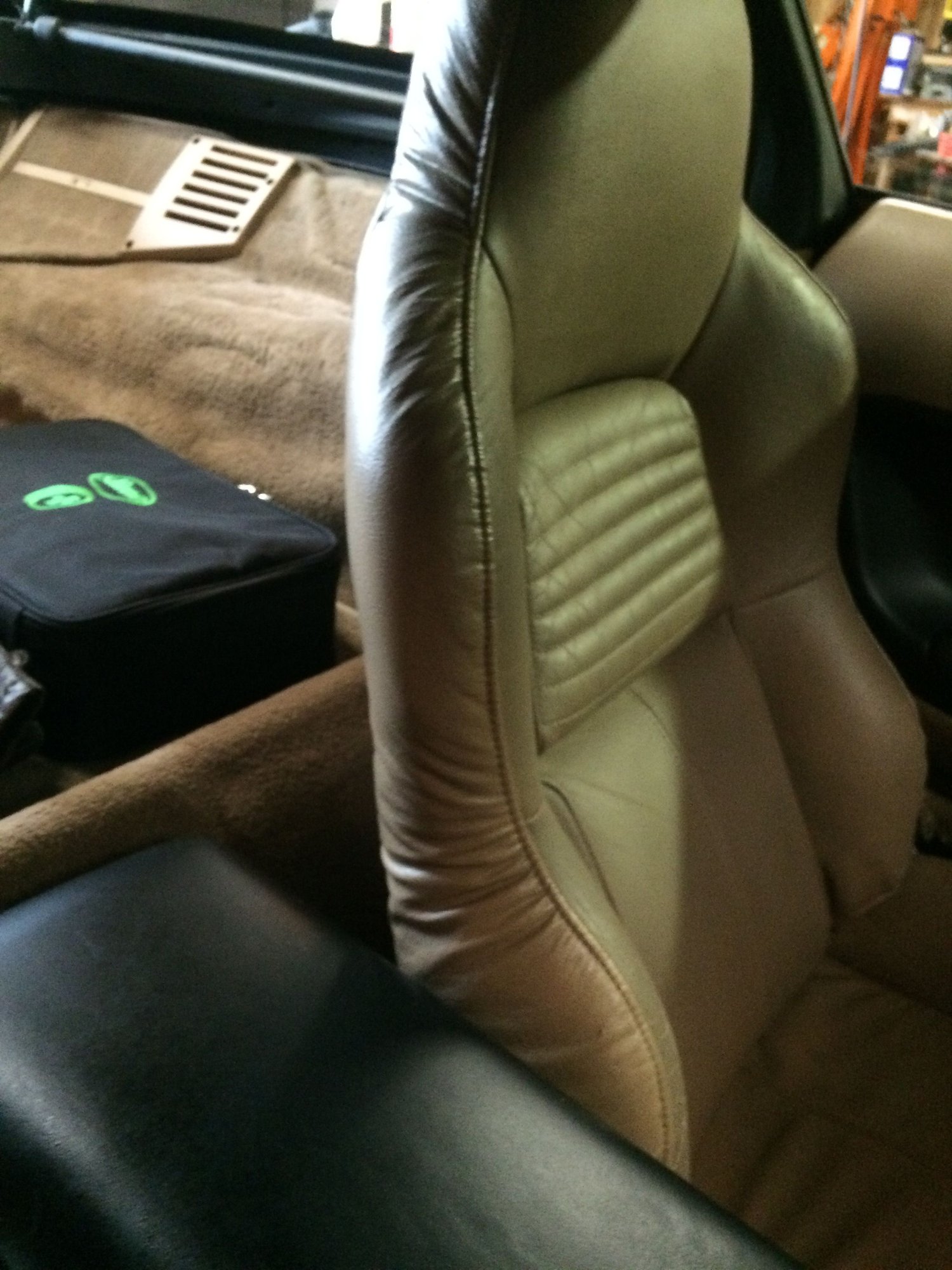

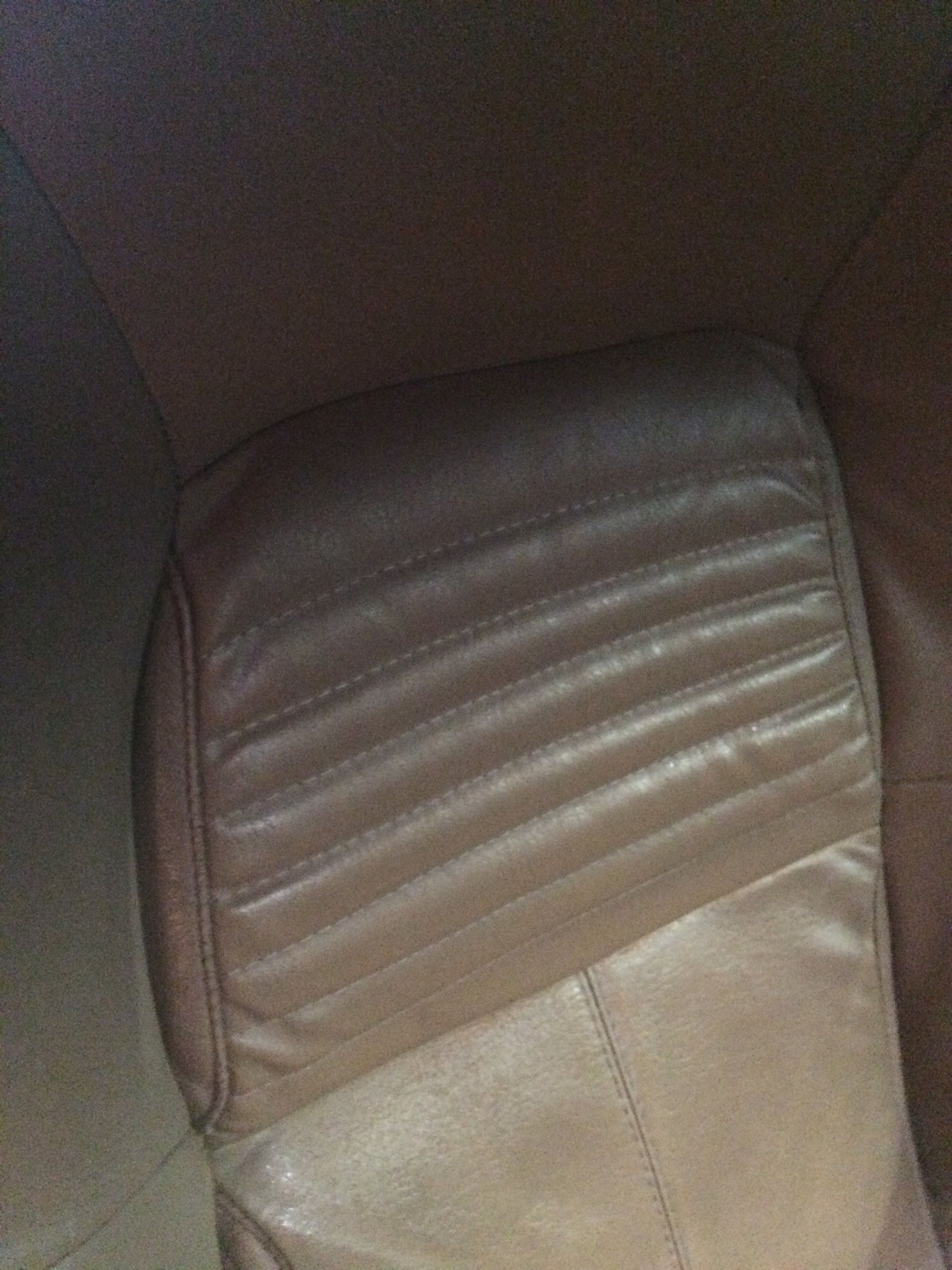

right side
left side
right side
left side
right side backrest now on driver's side
left side (notice the flattened lumber and upper support ) on right side
right side on driver's side
flattened former driver's seat
