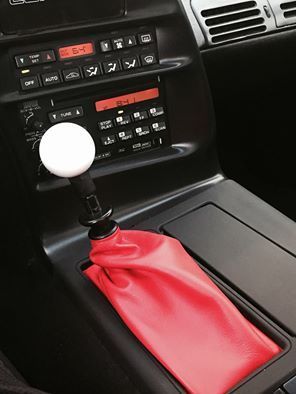

I replaced the stock shifter **** on my 96 several years ago. If I recall correctly you pry the shift pattern piece out with a flat blade screwdriver and remove the metal wedge that holds it in place. I replaced it with a white Hurst round ****. I think the T handle will fit as long as the threads match.

I went with the white **** as well, kind of old school.

The hard part is getting that little "wedge" out that is under the shift pattern cap. It keeps the **** from rotating and unscrewing itself. Mine was pressed in there really tight and I had to put a vice-grip on it and tap UP on the edge of the vice-grip with a small hammer. I heard a story of a guy pulling up really hard on his, and when it finally released, he put his elbow into the tinted roof and cracked it! So be careful if it is in there tight.
