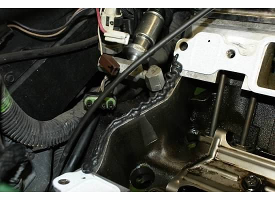

Originally Posted by Hot Rod Roy
Who has found a good way to keep those squirmy gaskets at the front and back of the intake manifold that are supposed to fit on the top of the "China walls" on the L98's? I know, some will say just throw them out and use RTV, but that makes such a mess to clean up the next time! There must be a secret to success!
The Fel-Pro intake manifold gasket sets I've used recently did not have those China wall gaskets in them. They supplied a tube of RTV and that's what I used.
You don't need to dimple the China wall if you put a generous amount of RTV on it. It will squoosh out and make an o--o shape. After it does that it can't move:
- if you get the china walls, PLUS, the mating surface of the intake, "squeaky" clean, and with a sufficient amount of sealant, there's absolutely no reason to dimple the walls. I've never had an issue with clean-up the "next time." when I say "squeaky clean" I mean cleaning with solvent!
