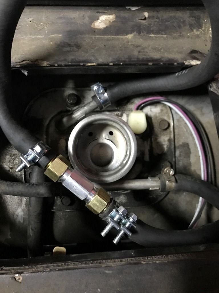

Root cause was a faulty fuel pump check valve. I ordered a Dorman 3/8 fuel pressure check valve on Amazon for $25. Save yourself $20 shopping at other locations. Part number is 800-196. Fuel pressure after an hour is still at 30 psi versus immediately dropping to zero. I'll add more details and pictures to my build thread. Here is a picture of what the part looks like. I am surprised that my brand new Delphi pump assembly never worked as I've had this start issue since day one.

Hi HRR,
#2 ruled out when I replaced the pulsator with hose and 4 clamps.
This repair verifies that #1 is the root cause, the fuel pressure regulator is acceptable as is, and the remanufactured fuel injectors I installed from FIC are not leaking.
You are correct that the true repair would be to R&R the fuel pump assembly and replace the fuel pump. This is a Delphi assembly that I purchased on Amazon which has a lifetime warranty. There are a lot of great reviews from Corvette owners on this product. I was just unlucky. I will probably put in a warranty claim down the road, but this fix resolves the hard starting I've had since I rebuilt the car. Check out my build thread. The new Delphi unit's fuel pump check valve was defective out of the box.
Fuel pumps are not cheap, and this is a great way to rule out the problem, and possibly fix if you are not interested in pulling the fuel pump assembly out.

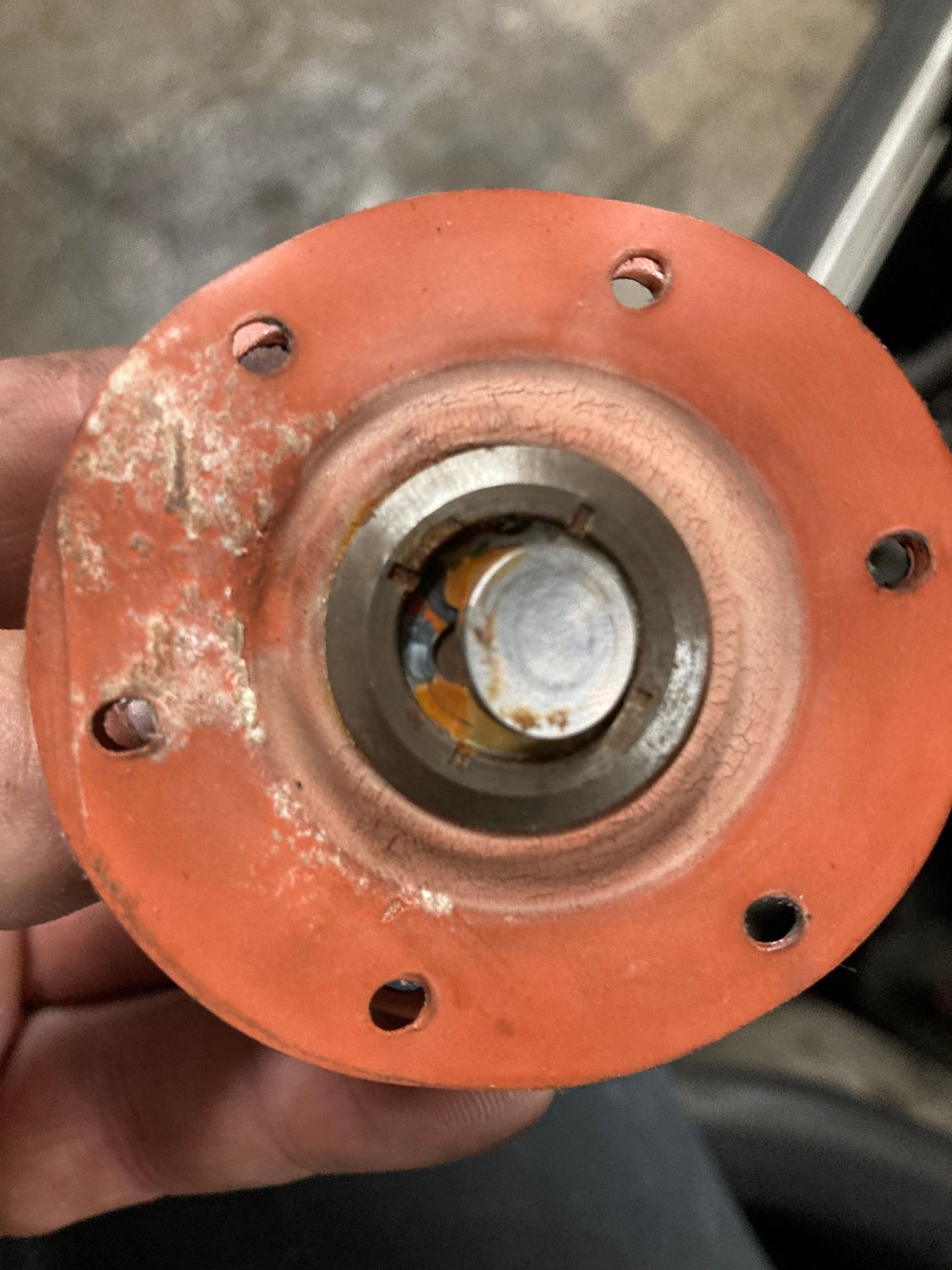

So I replaced the fuel pressure regulator diaphragm. Got it all back together and no change on pressure. Actually less pressure. Pump sounded weak. Took it back and Brooklyn at autozone said that fuel pump was wrong.
She said is was universal pump and had a max flow of 22 psi, which is all I was getting. My injectors need 24 psi.
So the correct pump with higher psi is ordered now. Hopefully that fixes my issue.
