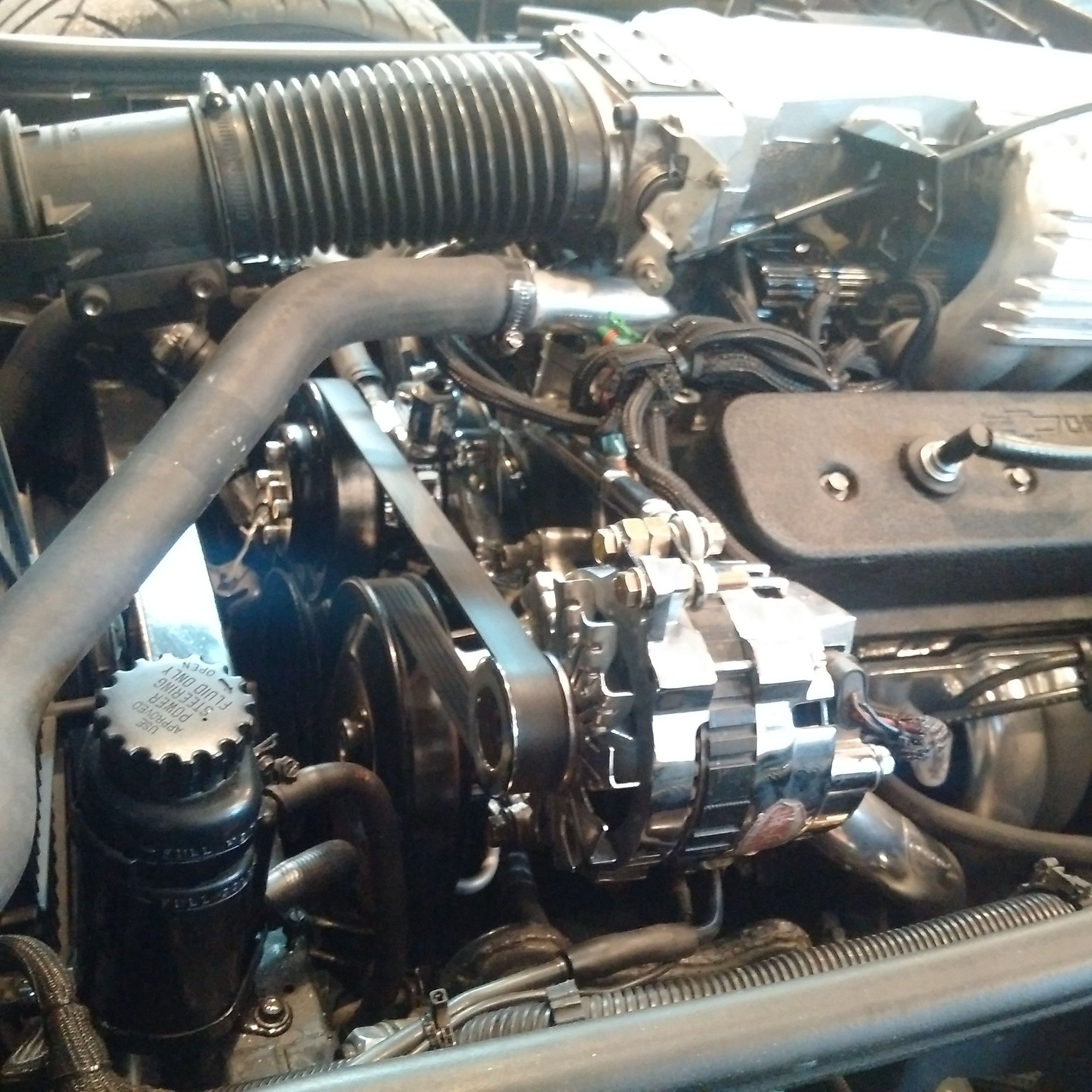

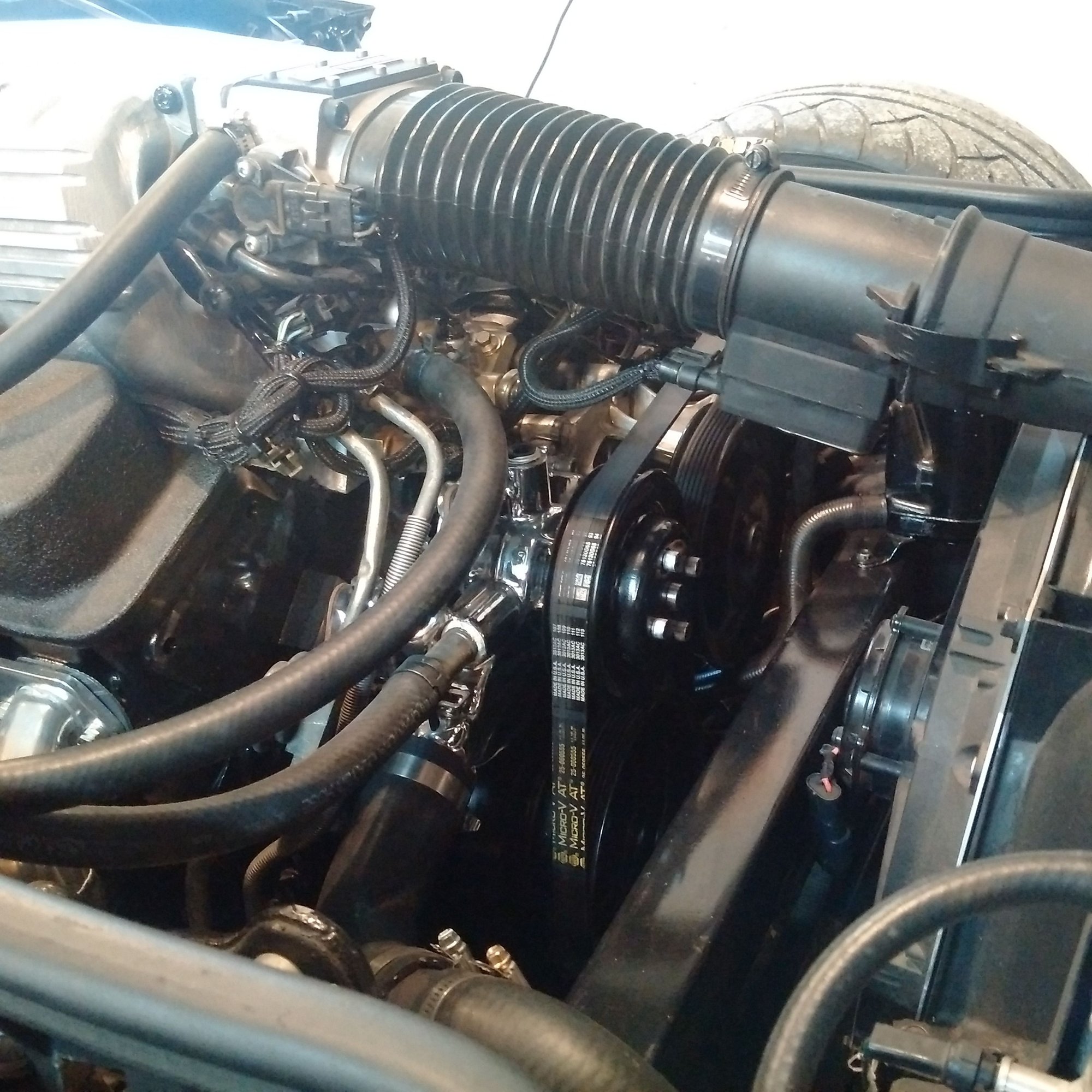

I just deleted my A/C and air pump. In my build thread (DMITTZ's Corvette build) I showed how I built an A/C delete heater box that keeps the stock fan. I haven't posted how I did the serpentine assembly yet so I'll try to explain what I did:
I wanted the most simple clean look so I got rid of the the A/C compressor and bracket as well as the tensioner, I got rid of the Air pump.
next I switched the water pump for a regular rotation short style chevrolet water pump. (stock pump is reverse rotation). In order to use the stock pulley I made a small spacer to move the pulley out like 1/8in so It would line up with the other pulleys.
I then bought a threaded rod with heim joints on each end that connects from the top of the water pump to the Alternator and I used it to tension the belt.
then buy a 56inch belt and run it under the crank pulley, across the P/s pulley like normal, around the alternator like normal, then run the belt straight across the top of the water pump and that's it. Just use the threaded rod to push the alternator out to tension the belt. You will also need to make a hose coupler to so you can connect a lower rad hose that fits the larger inlet on the water pump to the stock smaller hose that connect to your Rad. deleting your A/C this way is super simple and it works awesome plus looks really clean!
Here's some photo's of my serpentine setup:
Hope that helps you out!

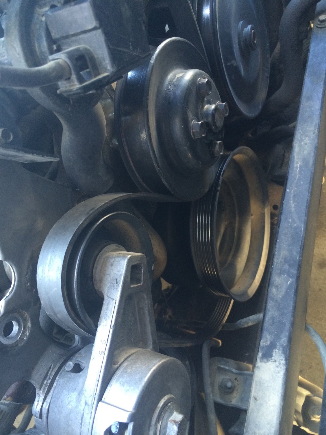

Hey guys in the middle of doing this ac delete and I was going to go with the ac bypass pulley as I can't delete the pump because I live in ca. Anyways I was putting the bypass pulley on when the bracket broke. Literally broke. So I need a shorter belt. I think I figure out how to route it without a pulley being there I just need a shorter belt. How short do you guys think I should get it? Here's a pic on how I think I'm gonna route it. Let me know if this would work. It basically just going up through the tensioner instead of around it.
Old Apr 16, 2016 | 09:11 PM
.50ae's Avatar
.50ae
Joined: Apr 2015
Posts: 145
Ok so I measured out the belt that I would need and it came out to like 74 or 75 inches without the tensioner tensioned. So I am going to go get a 72 inch belt from autozone tomorrow and we'll see how that works. This way the water pump will still run in the reverse rotation it's supposed to. I do really like dmittz's setup because the bracket kind of looks out of place there without a compressor on it. I'm doing this as kind of a bandaid until I can do something like dmittz's because I daily my c4. Maybe same thing but a little bit of a longer belt so I can retain the air pump?
