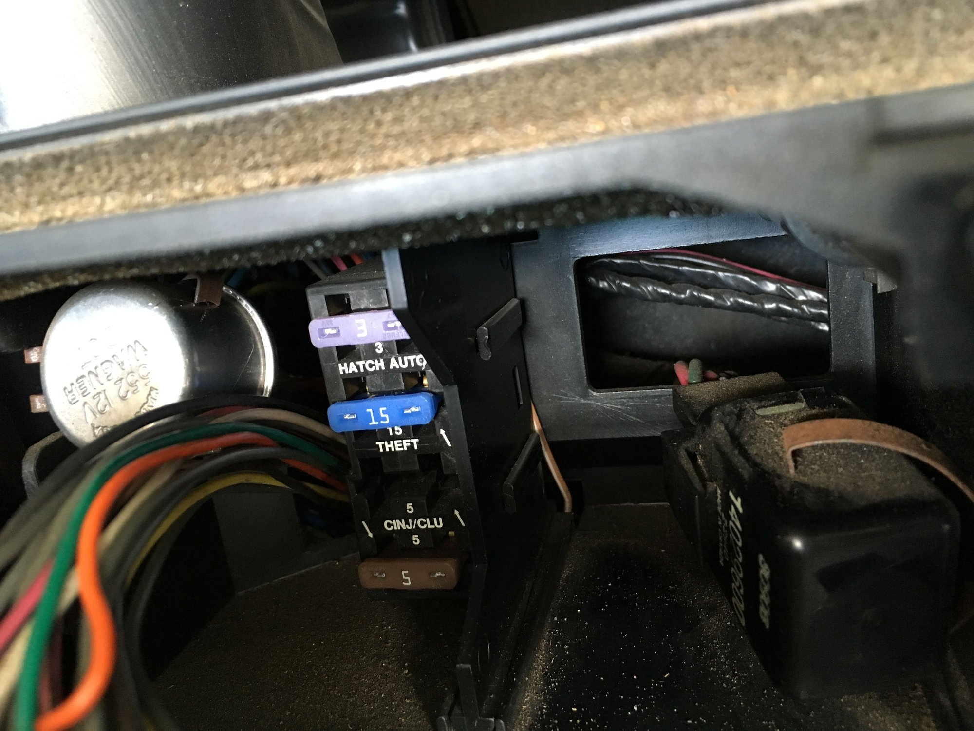

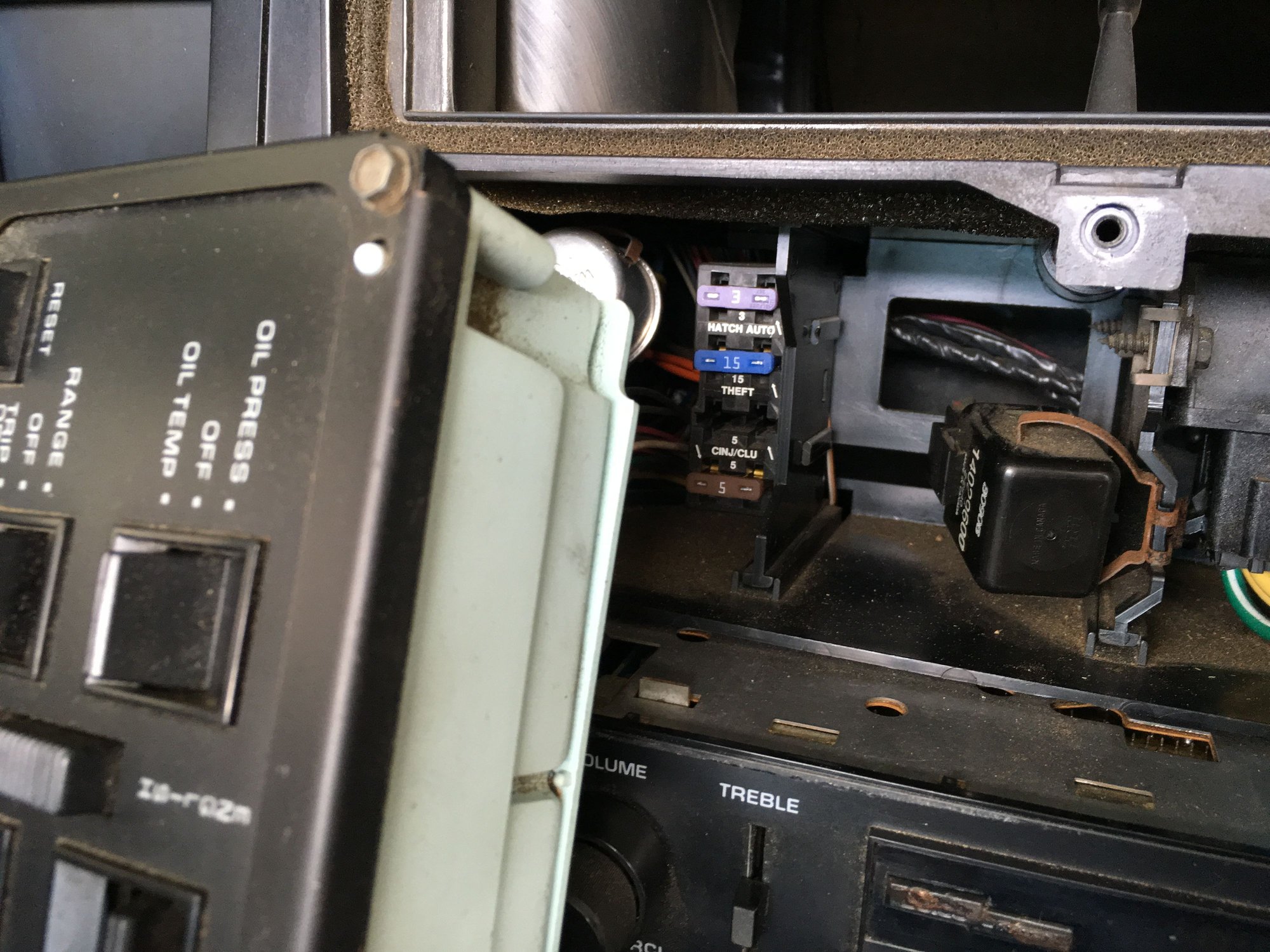

Bumma guys,
Still no luck with most of the suggestions above. I found these fuses behind the center console and got excited, replaced them and still didn't work. All switches make no sounds and silver braided cable for manual pop was already ripped out. Didn't even know about the switches to pop the back that were on the ends of the doors. I will get better manuals for more insight when I get there.
Currently waiting on some parts. Waiting for part sucks!
