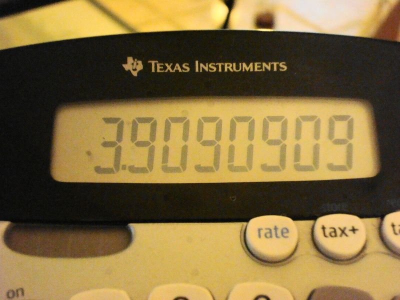

I had a 3.91 in my C4 and it was fun to drive
Last year I changed them to 3.54.
This is the ratio...
Your calculations "jogged my memory" and the 43/11 combination came back to me. My 3.92 (3.90/3.91 whatever) was a 26 spline build 47/12 (3.9166666) with the welded sleeve and older school stuff.
