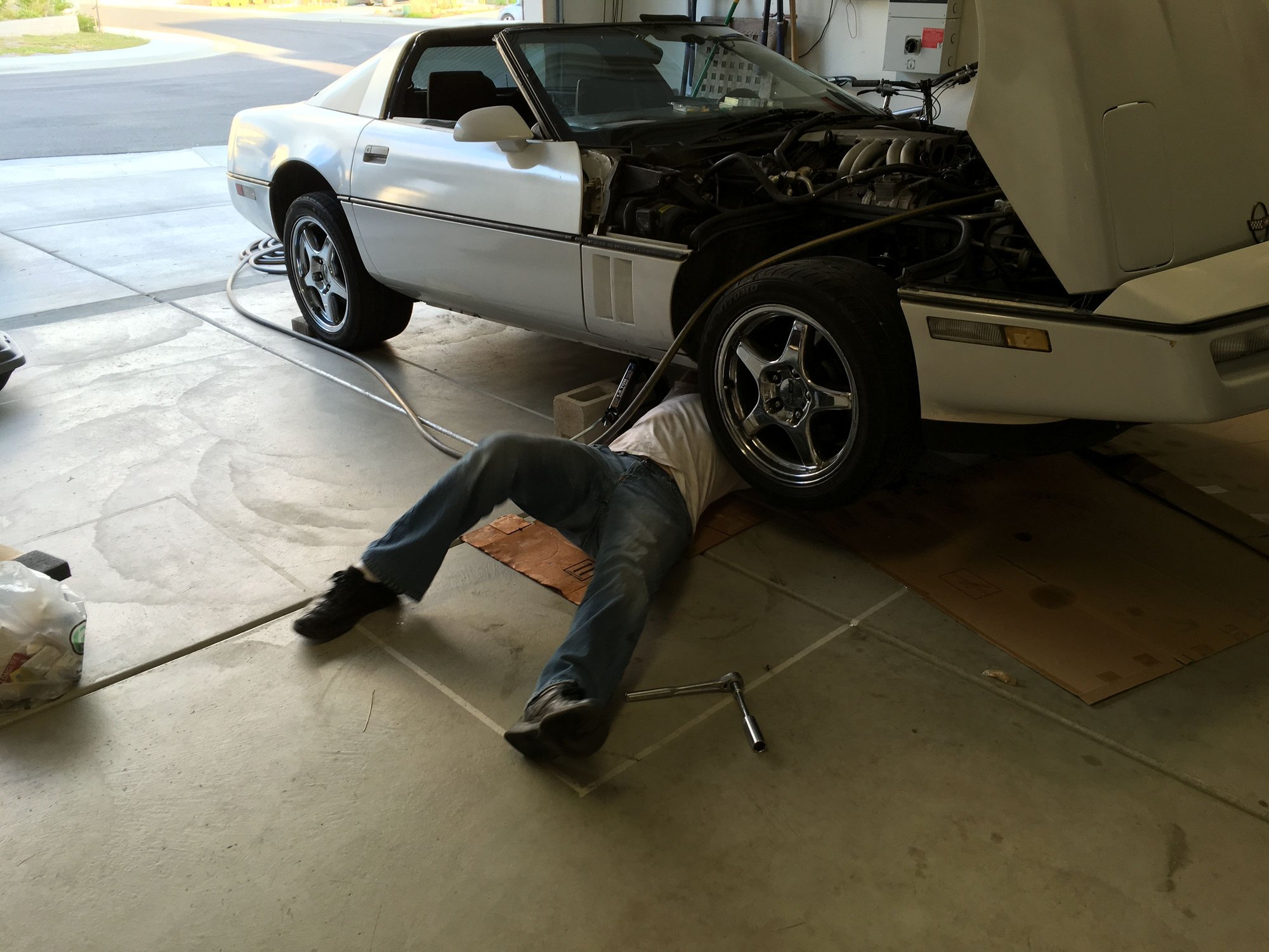

Thanks to the many threads I have read I was able to flush the coolant out the Rad and block by removing the KS. Now for the refill and was wondering if I should prime the block with coolant via the stat hole or is simply filling the rad and running and refilling just as good. Also not sure if I have to replace the KS. It was was messy and I wasn't really prepared for the river that would follow removing the KS lol.

Wish my garage was that neat. Gonna have to pull the KS also as I am replacing the rad.
