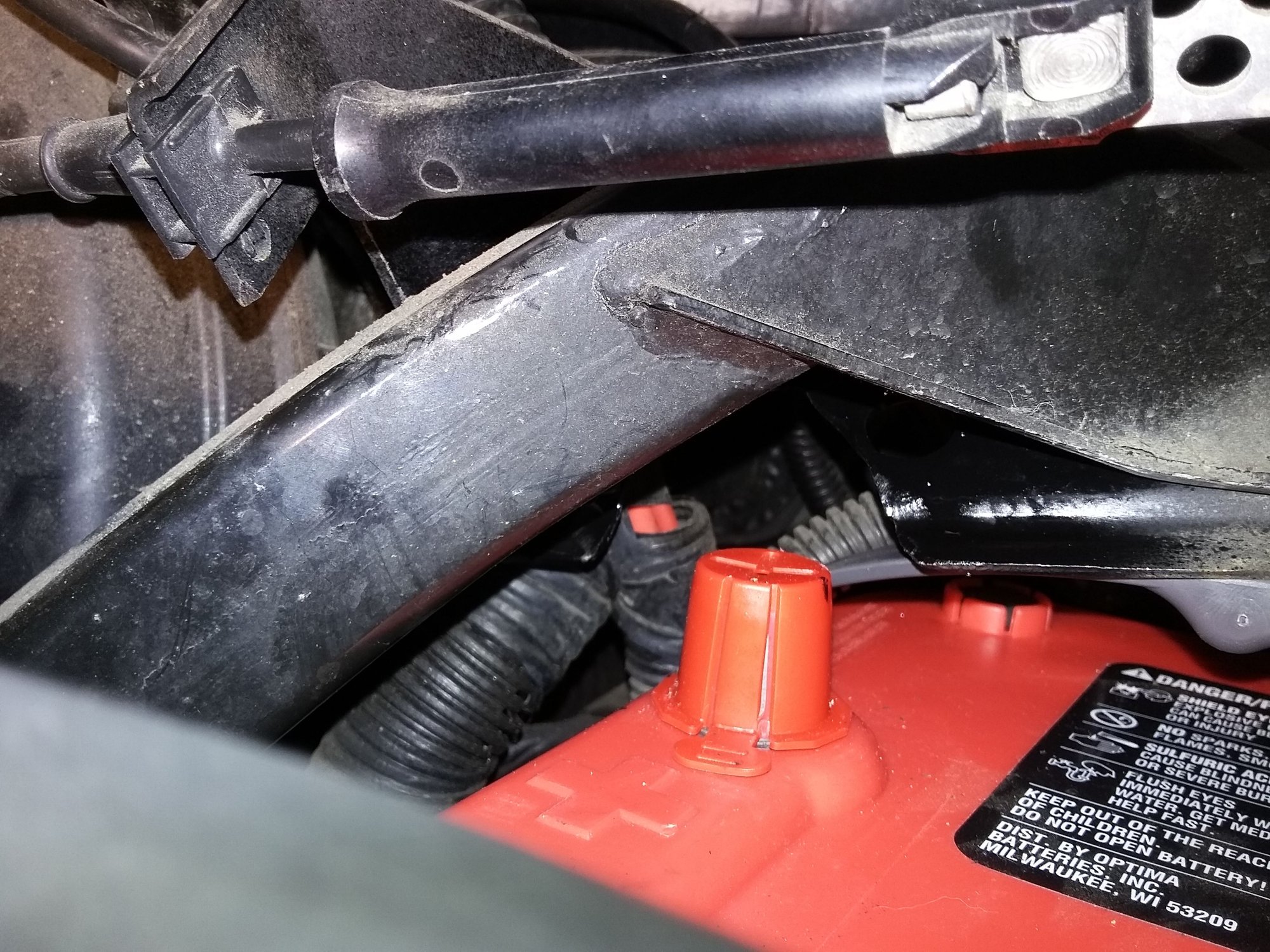

The battery looked to be fully charged this morning, just had it tested and they say its good at 87%. Went to NAPA this time to have the ICM tested but they cant test them they said. I had checked before and it would still work but had the slow start problem then the new one worked one day then failed then installed my original one and it started with no problem, no long start but now it doesn't start at all, like maybe it completely failed.
Tonight I installed a new Optima gel battery, I wanted one anyways. I had to trim the cruise control canister bracket and a bit of the battery tray for it to fit correctly and to make sure it wouldn't sort the positive post(dual post). I cleaned the jump box behind the battery including all connectors til shiny. Checked the ground by the battery and it looked good. Where are any other ground points I should check? Can a bad ICM prevent injector pulse?
