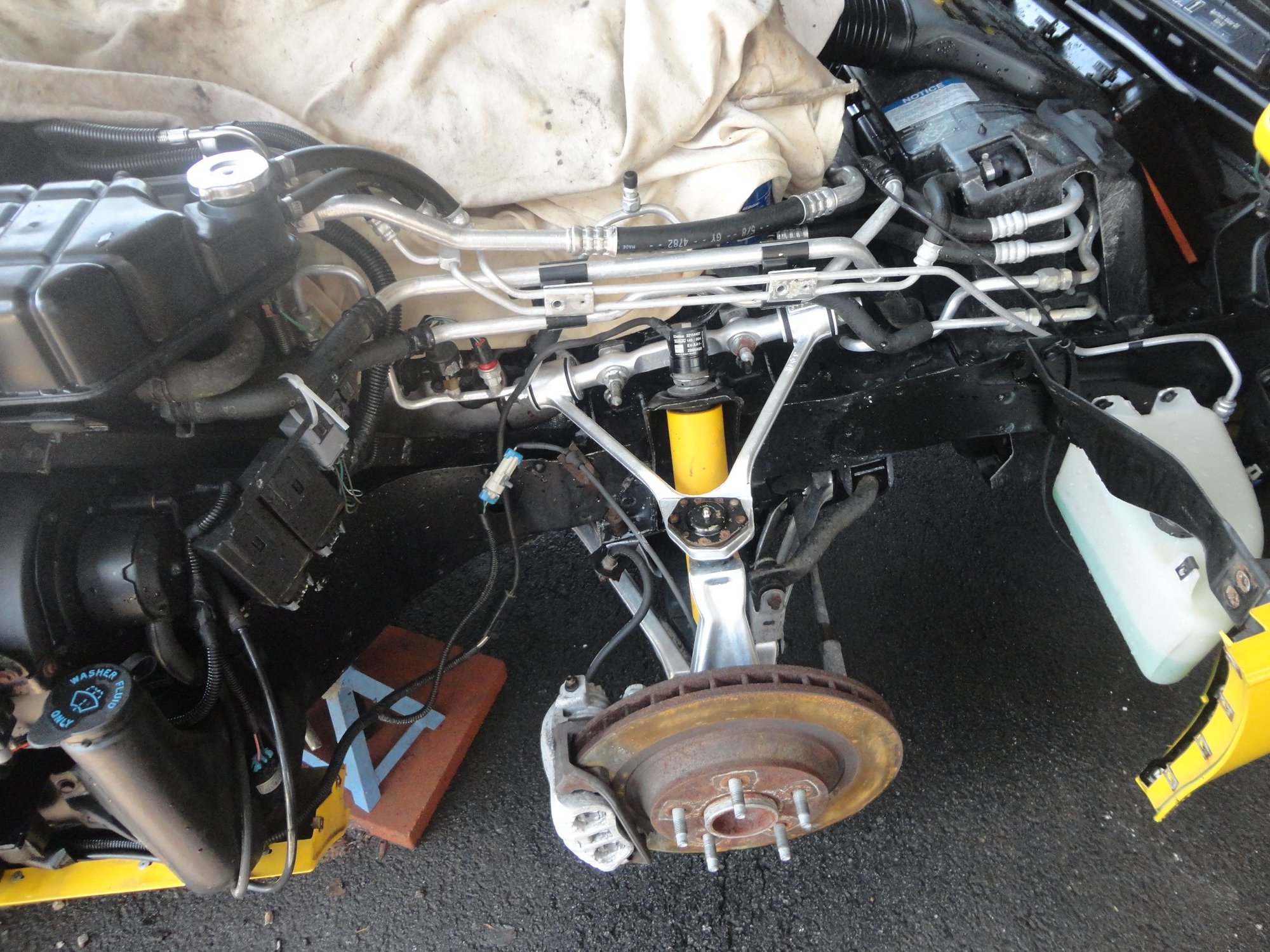

Originally Posted by ovrebo1
I pressure washed and de-greased my car top to bottom when I got it back from being neglected by my parents for about 5 years. I just did the obvious and stayed away from electrical connections and I had no problems.
I see you jacking up the one side. What do you use under the car? Degreaser there too? I am trying to pick up as many tips as I can on cleaning. The wife shut me done on buying any new parts so I have switched to cleaners and wax. I never thought about cleaning the underside. But plan on doing it now. Thanks for the pic.

Likes: 86
I just bought a bunch of cans of engine de-greaser. Sprayed it on all the spots that had years of caked on grease. Let it soak in for a bit (the can probably tells you how long you should do it for) then pressure washed it all off. I brakaleen'd all the other areas. I use a ton of brake-cleaner on all my projects. Don't ever get that stuff on plastics though. If you think your going to make a mess its really worth just doing it at a car wash bay. Like you noticed though, with a jack you can really get everything.
