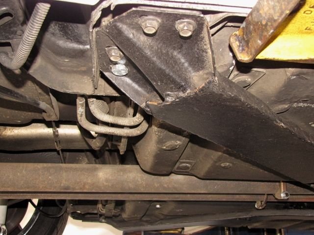

I acquired a vert X brace and it's and it is a little beat up. My question is : The front part is mostly straight or flat. The rear sections are bowed toward floor before it try to remove bowing are they supposed to be flat or bowed? Thanks

Post a pic

boxed in stock piece

Originally Posted by pologreen1
Hey, that's mine.........
A pic of it installed....
The are supposed to be flat as they bolt to the floor. After a few speed bumps they tend to get pushed in. Take it out, put a block of wood under each attachment point and jump up and down on the middle a few times. It should straighten right out.

I figured it should be flat. The few pictures I found of it they all appeared to be bowed, so I had to ask. A friend volunteered to straighten and box it for me. thanks for replies
